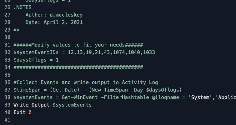

The default $systemEventIDs array is 12, 13, 19, 21, 43, 1074, 1040, 1033. Those IDs cover service-control, Windows Update Client, and shutdown lifecycle: service start (12) and stop (13), update installation success (19), update reboot required (21), update installation started (43), planned shutdown initiation (1074), and MSI installer activity (1040, 1033). The combined set surfaces unexpected reboots and installer events alongside the Windows Update entries, which helps you correlate a failed update with a service restart or a forced reboot inside the same time window. Common alternate IDs to add when troubleshooting include 20 (installation failure), 25 (restart pending), 31 (scan failure), and 44 (download started).

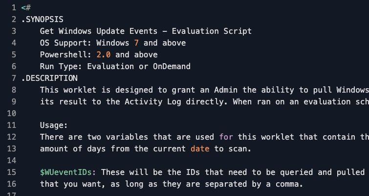

  1. Evaluation phase: The evaluation script exits with code 1 to flag every endpoint for remediation, because the Worklet is a read-only audit job and the value is in collecting the events on each run. There is no idempotency check; the script is intentionally a one-shot collector that you point at the time window you care about.
  2. Remediation phase: The remediation script builds a TimeSpan from the configured $daysOflogs value and the current Get-Date, then calls Get-WinEvent -FilterHashtable @{logname = 'System','Application'}. The result is filtered by the $systemEventIDs array (default 12, 13, 19, 21, 43, 1074, 1040, 1033) and any TimeCreated newer than the lookback window. Output is formatted with Format-Table TimeCreated, Id, Message -Wrap and written to stdout, which the Automox agent forwards to the Activity Log. The script exits 0 on success.

  • Windows 7 or later, Windows Server 2008 R2 or later. Workstation and Server SKUs are both supported by the source metadata.
  • PowerShell 2.0 or later. Get-WinEvent is part of the in-box PowerShell on every supported Windows release.

  • Set $systemEventIDs in remediation.ps1 to the comma-separated list of event IDs you want returned. The script queries the System and Application logs and ships with a default of 12, 13, 19, 21, 43, 1074, 1040, 1033. Add 20 (installation failure), 25 (restart pending), 31 (scan failure), 41 (unexpected shutdown), or 44 (download started) when you need a broader view; the Worklet will return any of those IDs that appear in the System or Application logs within the lookback window.
  • Set $daysOflogs to the lookback window in days. The default of 1 returns the last 24 hours; raise it to 7 or 30 when you are gathering audit evidence across a patch cycle.
