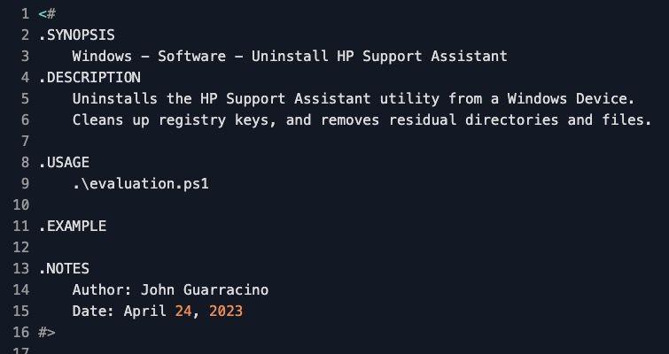

This Automox Worklet™ removes HP Support Assistant from Windows endpoints and cleans up the service, registry, and file artifacts the standard uninstaller leaves behind. HP Support Assistant ships preinstalled on most consumer and commercial HP laptops as a Microsoft Store (AppX) package, with the legacy HP Support Framework directory providing the underlying binaries. The Worklet detects the AppX package, stops associated services, runs the vendor's silent uninstaller, and sweeps residual directories so your fleet ends in a consistent, clean state.
Detection queries Win32_InstalledStoreProgram and filters for any package whose Name matches *HPSupportAssistant. If a match is found, remediation stops the four HP services (HPAppHelperCap, HPDiagsCap, HPNetworkCap, HPSysInfoCap), removes the HKLM:\SOFTWARE\WOW6432Node\HP\HPActiveSupport registry key, and runs UninstallHPSA.exe with /s /v /qn UninstallKeepPreferences=FALSE for a silent vendor uninstall. After the uninstaller exits, the Worklet sweeps C:\Program Files (x86)\HP\HP Support Framework\ and C:\ProgramData\HP\HP Support Framework\, using [IO.Directory]::Delete with recursive=true as a fallback when Remove-Item is blocked by an open handle on the HPSFMessenger9_3 resource directory.

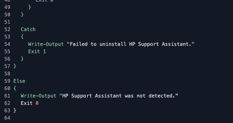

  1. Evaluation phase: The Worklet queries Win32_InstalledStoreProgram and filters with Where-Object for any package whose Name matches *HPSupportAssistant. If a matching package is found, evaluation exits 1 and flags the endpoint for remediation; otherwise it exits 0 and the endpoint is marked compliant.
  2. Remediation phase: Stop-Service halts HPAppHelperCap, HPDiagsCap, HPNetworkCap, and HPSysInfoCap with -Force -ErrorAction SilentlyContinue so a missing service does not abort the run. Remove-Item purges HKLM:\SOFTWARE\WOW6432Node\HP\HPActiveSupport. Start-Process then runs C:\Program Files (x86)\HP\HP Support Framework\UninstallHPSA.exe with /s /v /qn UninstallKeepPreferences=FALSE for a fully silent vendor uninstall. Residual cleanup removes C:\Program Files (x86)\HP\HP Support Framework\* and C:\ProgramData\HP\HP Support Framework\*, with [IO.Directory]::Delete used as a fallback when Remove-Item is blocked by an open handle on the HPSFMessenger9_3 resource directory. If the residual sweep fails, the Worklet exits 0 and surfaces a warning in the Automox activity log that some HP Support Assistant files may remain on the endpoint.
