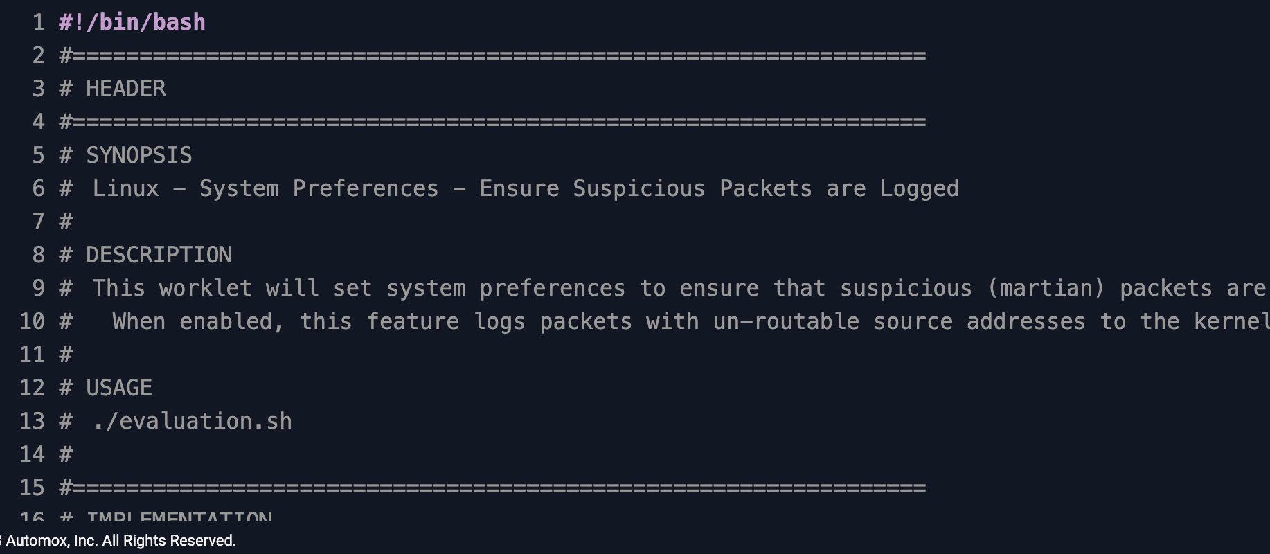

This Automox Worklet™ enforces kernel-level logging of martian packets on Linux endpoints. A martian packet is an IP frame with a source address that should never be routable on the receiving interface, such as a private RFC 1918 range arriving on a public link, the 127.0.0.0/8 loopback range on an external NIC, or a multicast or reserved range that has no business on a unicast path. Logging these frames turns each endpoint into a low-cost network sensor and gives your security team a signal that lives below the application layer.
The Worklet operates on two kernel parameters: net.ipv4.conf.all.log_martians and net.ipv4.conf.default.log_martians. The all key flips logging on for every existing interface; the default key inherits the setting onto any interface created later. Both must equal 1 for the endpoint to meet the CIS 3.3.x control family for suspicious packet logging.
Persistence is the second half of the job. When no martian logging entry already exists under /etc/sysctl.d/, the Worklet writes /etc/sysctl.d/automox_martian_logging.conf so the kernel re-applies both keys on every boot. It then runs sysctl -w against the live kernel and flushes the routing cache with sysctl -w net.ipv4.route.flush=1 so the change takes effect without a reboot.
The script is non-destructive. The remediation script checks whether any existing /etc/sysctl.d/ file already references martian logging. If one exists, the Worklet skips writing the drop-in but still applies both keys to the running kernel with sysctl -w and flushes the routing cache to bring the runtime state into compliance.

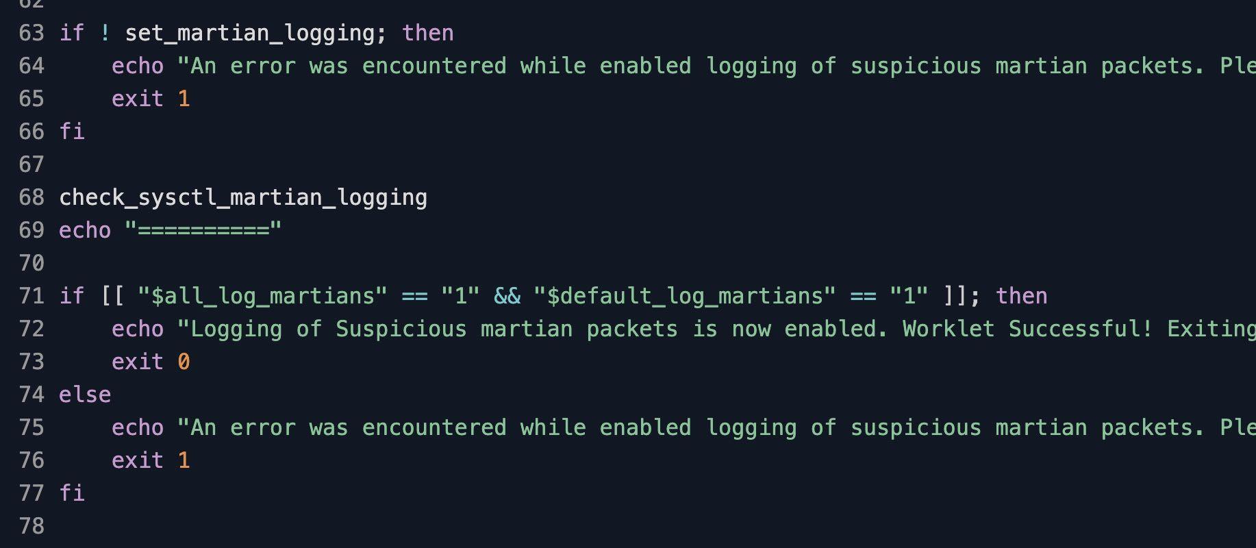

  1. Evaluation phase: The Worklet reads the live runtime values with sysctl -n net.ipv4.conf.all.log_martians and sysctl -n net.ipv4.conf.default.log_martians. If both return 1, the endpoint is compliant and the script exits 0. If either returns 0, the Worklet flags the endpoint non-compliant and triggers remediation. The check is intentionally cheap so it can run on a tight policy interval without measurable load.
  2. Remediation phase: The remediation script writes /etc/sysctl.d/automox_martian_logging.conf containing net.ipv4.conf.all.log_martians = 1 and net.ipv4.conf.default.log_martians = 1. It applies both keys to the running kernel with sysctl -w, flushes the routing cache with sysctl -w net.ipv4.route.flush=1, and re-reads the values to confirm. On distributions that ship a populated /etc/sysctl.conf, the Worklet also runs sysctl -p to reload the file. The script exits 0 on success or non-zero with a stderr message if the keys cannot be set, surfacing the failure in Automox activity logs.

After a successful run, sysctl net.ipv4.conf.all.log_martians net.ipv4.conf.default.log_martians returns 1 for both keys, and cat /etc/sysctl.d/automox_martian_logging.conf shows the two key/value pairs that hold the setting across reboot. Subsequent evaluation passes report the endpoint as compliant without re-running remediation, because the kernel state already matches the baseline.
