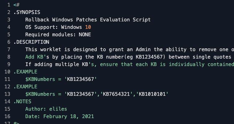

This Automox Worklet™ removes specific Windows KB updates from Windows 10 endpoints by uninstalling the underlying Windows package. The Worklet drives DISM (Deployment Image Servicing and Management) through PowerShell to find each installed package by KB number and remove it from the online system.
Internally the Worklet builds a hashtable that maps each KB number to its full Windows package name using Get-WindowsPackage. You list the KB numbers to remove in the $kbNumbers variable, separating multiple values with commas (for example, 'KB5005565','KB5006670'). The Worklet then walks the hashtable and calls Remove-WindowsPackage for each KB the endpoint actually has installed.

  1. Evaluation phase: The Worklet queries every installed Windows package using Get-WindowsPackage in native context, then extracts the KB identifier from each package's metadata. It builds a hashtable mapping KB numbers to package names and checks whether any of the KB values in $kbNumbers are still present. The endpoint exits with code 0 (compliant) when none of the target KBs are installed and exit code 2 (non-compliant) when at least one remains.

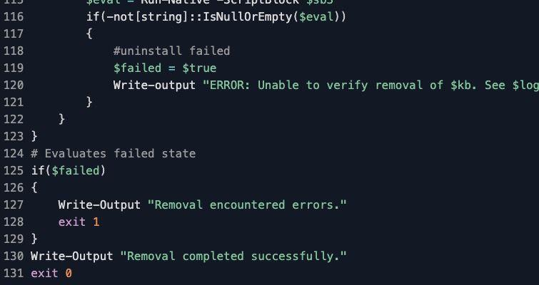

  2. Remediation phase: The Worklet calls Remove-WindowsPackage for each matching KB, passing the package name from the hashtable and the configured -LogPath for DISM output. After each removal, it re-queries the package with Get-WindowsPackage and confirms the state is UninstallPending. A failed removal or an unchanged state writes an error to stderr and exits with code 2375 so the Automox console flags the endpoint for follow-up. A clean remediation exits with code 0.

  • KB identifiers for every patch you want removed, in KB####### format (for example, KB5005565, KB5006670, KB5034441).
  • Edit the $kbNumbers variable in both the evaluation and remediation scripts, and list each KB as a single-quoted string separated by commas.

After successful remediation, each targeted package sits in UninstallPending state and finalizes removal on the next system restart. The Worklet does not force a reboot, so you can stage the restart inside a maintenance window or follow up with a separate reboot policy. Validate the pending state from PowerShell with Get-WindowsPackage -Online | Where-Object PackageState -eq 'UninstallPending'.
DISM writes a per-KB log file named KB#######.log to the log path. Open that file when a removal fails to see exactly which servicing operation rejected the request. Typical failures include a superseded package that no longer has an uninstall scenario, a package locked by a pending operation from a previous Patch Tuesday, and a permanence flag set by Microsoft on a security update that cannot be cleanly reverted.
