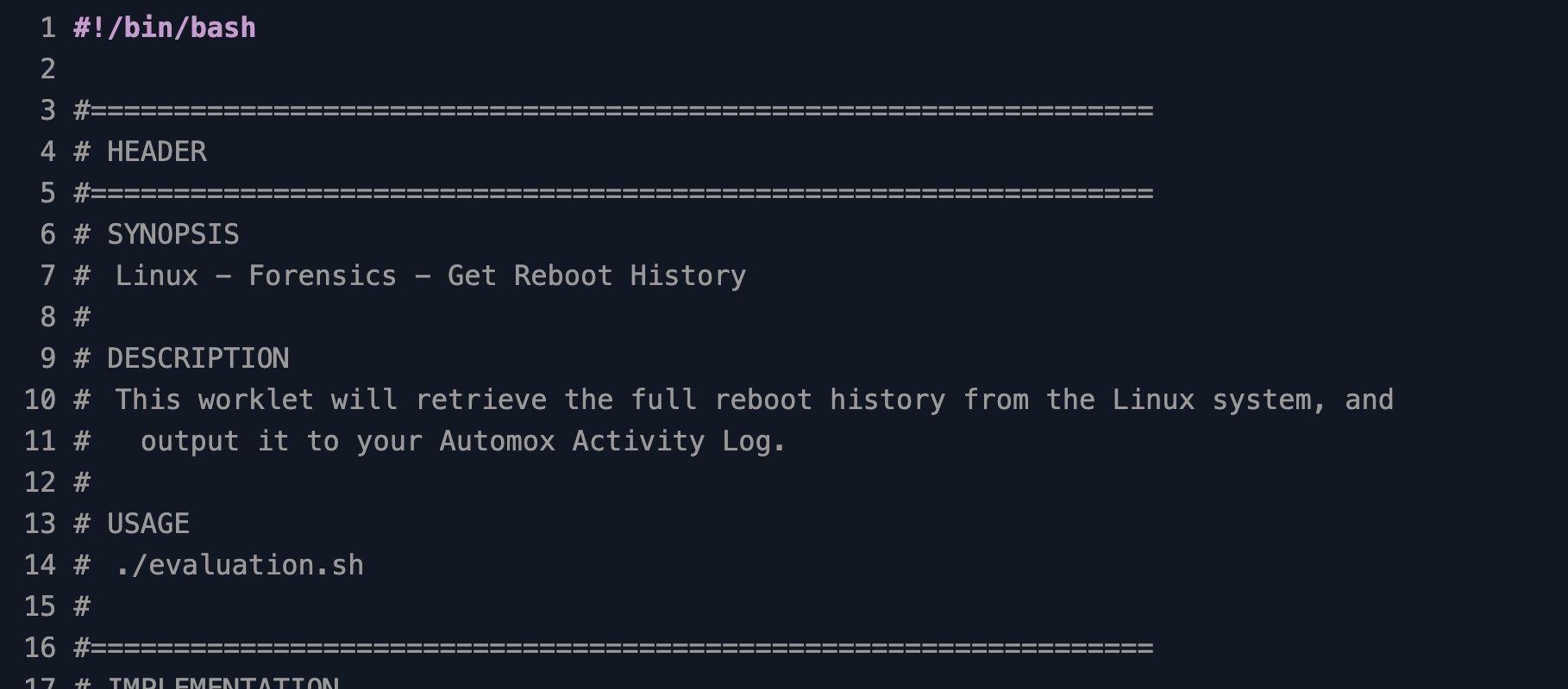

This Automox Worklet™ reads the kernel reboot record from /var/log/wtmp on every Linux endpoint in scope and writes a structured table to the Automox Activity Log. The Worklet runs the last reboot command, which decodes the wtmp binary log into one row per system boot, then pipes the output through an AWK formatter that prints six fixed-width columns: Event, Kernel Version, Day of Week, Month, Day, and Reboot Time.
Because the Worklet logs to the Automox Activity Log rather than the endpoint console, the reboot record is captured centrally even if the endpoint is later reimaged or wtmp is rotated. The same data is reachable interactively on the endpoint with last -x | grep reboot, journalctl --list-boots on systemd-based distributions, and uptime --since for the most recent boot time. The Worklet collapses those three sources into a single fleet-wide report you can query from the Automox console.
The script is read-only. It does not modify wtmp, btmp, or any other system file, and it does not write to disk on the endpoint, so a daily evaluation policy can run against production database servers and container hosts without introducing any I/O or restart side-effects.

  1. Evaluation phase: The evaluation script exits with status 1 unconditionally. This is intentional. The Worklet is a data-collection action, not a drift check, so remediation must run on every policy execution to capture the current state of /var/log/wtmp. Treating evaluation as a no-op signal keeps the design simple and avoids false compliance on endpoints that never report any wtmp entries.

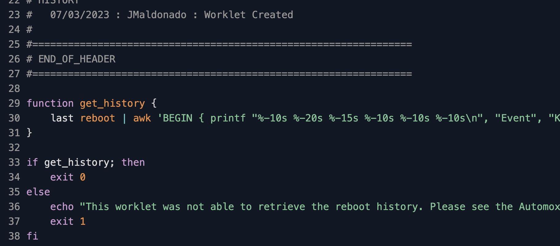

  2. Remediation phase: The remediation script defines a get_history function that runs last reboot and pipes the output to an AWK formatter. AWK prints a header row, a divider row, and then six printf-aligned columns built from fields $1, $4, $5, $6, $7, and $8 of each last reboot line. The pipeline is wrapped in an if check that exits 0 when AWK succeeds, and exits 1 with a descriptive message to the Activity Log if the formatter returns non-zero.
