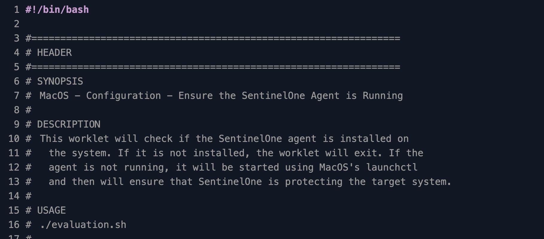

This Automox Worklet™ verifies that the SentinelOne EDR agent is registered with launchd and actively protecting a macOS endpoint, and restarts the launchd service when sentinelctl reports it is not running. The Worklet checks whether system/com.sentinelone.sentineld is loaded with launchctl print, then reads sentinelctl status to confirm the agent is reporting a healthy state. An endpoint where launchctl print fails is treated as not having SentinelOne installed and is left untouched.
When the launchd service is registered but sentinelctl status returns a non-zero exit, the endpoint is flagged non-compliant and remediated in the same policy run. The Worklet does not deploy or reinstall SentinelOne; pair it with your existing SentinelOne deployment Worklet for net-new endpoints, and use this Worklet to keep installed agents continuously active. A final sentinelctl status call decides the remediation exit code, so any daemon that refuses to come back up surfaces in the Automox Activity report instead of silently passing the policy.

  1. Evaluation phase: The Worklet runs launchctl print system/com.sentinelone.sentineld to confirm the SentinelOne launchd service is registered. If that call fails, the endpoint is treated as not having SentinelOne installed and the Worklet exits 0 without scheduling remediation. If the service is registered, the Worklet runs sentinelctl status and exits 0 when sentinelctl returns success. Any non-zero sentinelctl exit marks the endpoint non-compliant and schedules the remediation script.

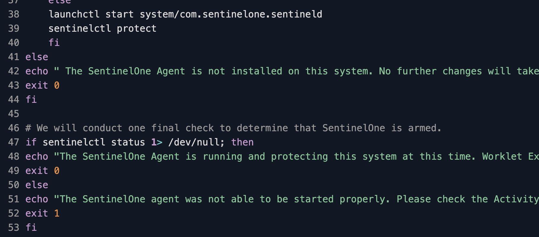

  2. Remediation phase: The remediation script re-runs the same launchctl print and sentinelctl status checks. When the service is registered but sentinelctl status fails, it runs launchctl start system/com.sentinelone.sentineld to relaunch the daemon and then sentinelctl protect to re-enable protection. A final sentinelctl status call decides the outcome: the script exits 0 when sentinelctl returns success and exits 1 with a guidance message pointing to the Automox Activity report and amagent logs when the daemon refuses to come back up.

After a successful run, launchctl print system/com.sentinelone.sentineld returns the service definition, sentinelctl status exits 0, and the SentinelOne management console shows the endpoint checking in within minutes. The Worklet is idempotent: the next scheduled evaluation finds the agent already running and exits 0 without taking action, so there is no drift loop and no extra noise in Automox Activity.
