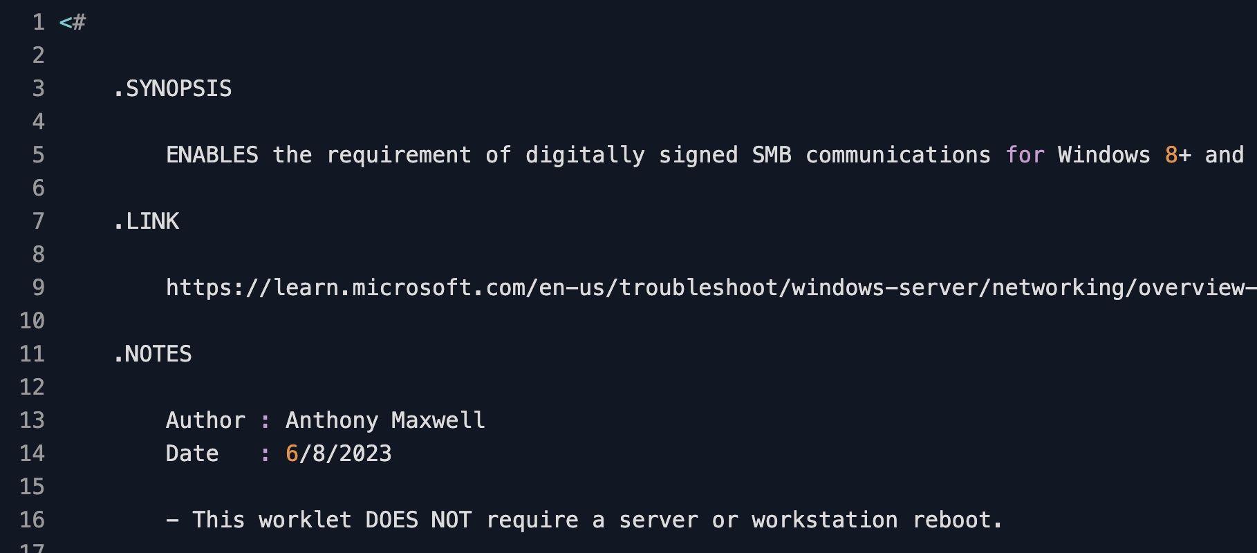

This Automox Worklet™ enables SMB digital signing on Windows endpoints by writing the EnableSecuritySignature DWORD to 1 in both the SMB client and SMB server parameter keys. SMB signing attaches a cryptographic signature to every SMB packet so the receiver can verify the packet has not been altered in transit. The configuration applies to Windows 8 and later workstations and to Windows Server 2012 and later, and the change takes effect without a reboot.

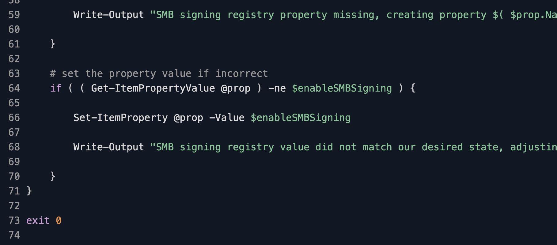

  1. Evaluation phase: The Worklet enumerates the two parameter keys at HKLM:\SYSTEM\CurrentControlSet\Services\LanmanWorkstation\Parameters and HKLM:\SYSTEM\CurrentControlSet\Services\LanmanServer\Parameters and reads EnableSecuritySignature with Get-ItemPropertyValue. If either value is missing or not equal to 1, the script writes a non-compliance message to stdout and exits 1, which queues remediation. If both values already equal 1, the script exits 0 and the endpoint reports compliant.
  2. Remediation phase: The Worklet walks the same two keys. For each missing property, it calls New-ItemProperty to create EnableSecuritySignature as a REG_DWORD with value 1. For each present-but-incorrect property, it calls Set-ItemProperty to overwrite the value to 1. The script logs the path it touched and the value it wrote to stdout, which surfaces in Automox activity logs. It exits 0 on success. No reboot is required; the SMB client and SMB server services pick up the new signing capability on the next session negotiation.

  • No reboot is needed; the SMB redirector and SMB server pick up the new EnableSecuritySignature value on the next SMB session
