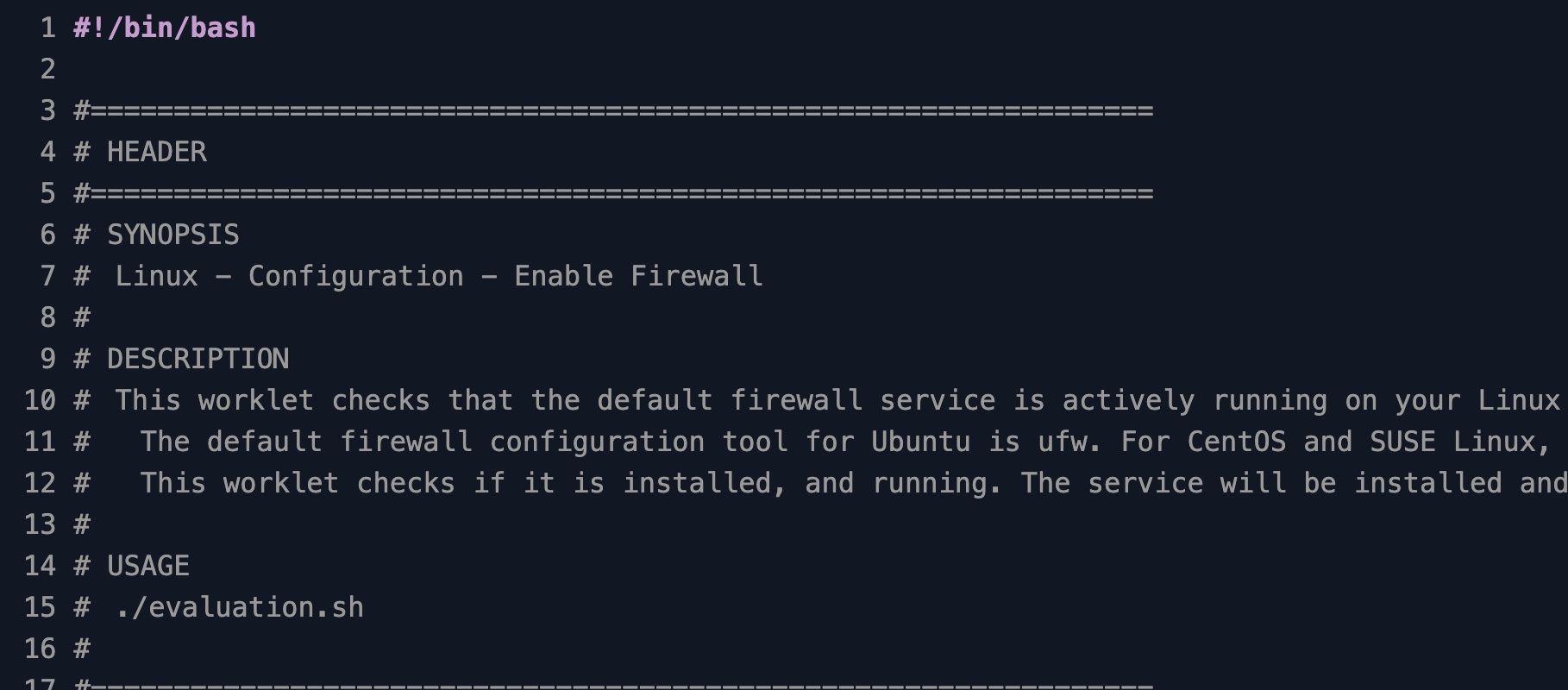

What the Linux host firewall enabler does
This Automox Worklet™ enables the recommended host-based firewall on Linux endpoints and keeps the service active after every evaluation. The Worklet reads /etc/os-release to detect the distribution, installs the right firewall package when it is missing, and starts the service when it is installed but inactive. Endpoints that already report ufw active or firewalld running pass evaluation and burn no remediation cycles, so a daily policy lands as a no-op on the hosts that pass and only installs a package on the hosts that fail.
On Ubuntu, the Worklet checks for /usr/sbin/ufw and runs ufw status to see whether the Uncomplicated Firewall is active. When ufw is missing, the remediation phase installs it with apt install ufw -y and turns it on by piping y into ufw enable. On RHEL, CentOS, Rocky, Alma, Fedora, SUSE, and Debian, the Worklet checks for /usr/bin/firewall-cmd and queries firewall-cmd --state. If firewalld is not installed, the remediation phase falls back through yum install firewalld -y or apt install firewalld -y, then runs systemctl enable firewalld and systemctl start firewalld.
The evaluation phase is idempotent. Once the firewall is active, every subsequent run exits 0 without restarting the service, so the policy can be scheduled daily as a drift control. When a build script, configuration management tool, or admin error disables the firewall, the next Automox run catches the regression and restores the service automatically.

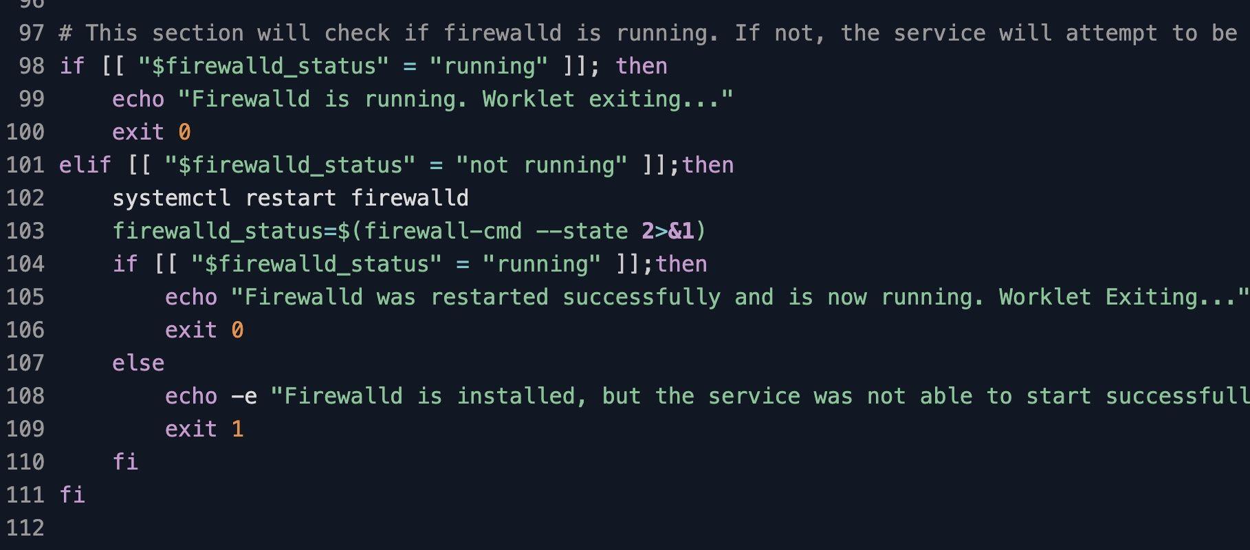

  1. Evaluation phase: The Worklet sources /etc/os-release to read the NAME field. On Ubuntu, it checks for /usr/sbin/ufw and parses the first line of ufw status to capture either active or inactive. On every other distribution, it checks for /usr/bin/firewall-cmd and reads firewall-cmd --state, which returns running or not running. An endpoint exits 0 when the firewall is installed and active. It exits 1 when the firewall is missing entirely, when ufw reports inactive, or when firewalld reports not running, which schedules the remediation phase.
  2. Remediation phase: On Ubuntu, the script runs apt install ufw -y when the binary is missing, then pipes y into ufw enable to activate the service and persist it across reboots. On RHEL, CentOS, Fedora, SUSE, and Debian, the script runs yum install firewalld -y with an apt install firewalld -y fallback, followed by systemctl enable firewalld and systemctl start firewalld. If the service is already installed but inactive, the script restarts it with systemctl restart firewalld or ufw enable. A final state check re-runs firewall-cmd --state or ufw status and exits 0 on success or non-zero with a message in stderr when the service refuses to start.
