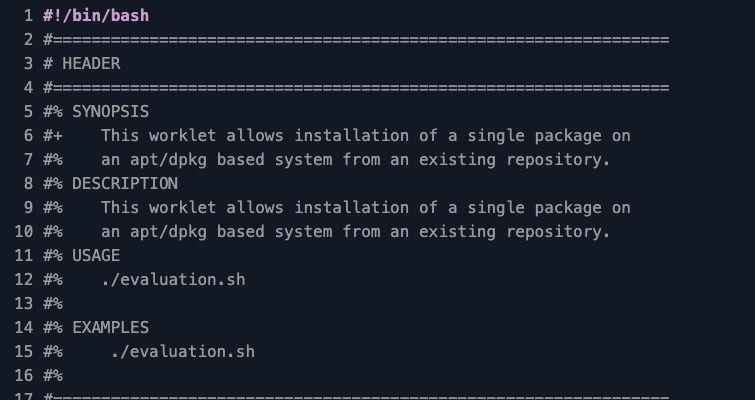

This Automox Worklet™ installs a single named package on Linux endpoints that use the apt and dpkg toolchain. You set the package name once in the REQUIRED_PKG variable at the top of remediation.sh. On each run, the Worklet asks dpkg whether that package is already installed and calls apt-get when it is not.
Debian, Ubuntu, Raspbian, Linux Mint, and other Debian-derived distributions are all in scope. The Worklet uses whichever repositories are listed in /etc/apt/sources.list and the files under /etc/apt/sources.list.d/. That covers upstream distribution mirrors, vendor repositories from Microsoft, Google, or HashiCorp, internal apt mirrors, and PPAs added earlier in the build pipeline.

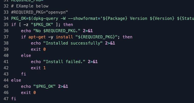

  1. Evaluation phase: evaluation.sh exits 1, so every targeted endpoint is queued for remediation. The actual install check runs inside the remediation script, which means you do not need to mirror the package name into a second file.
  2. Remediation phase: The remediation script runs dpkg-query -W --showformat='${Package} Version ${Version} ${Status}\n' "$REQUIRED_PKG" and greps for the literal string "install ok installed". When that string appears, the script echoes the dpkg line and exits 0. When it does not, the script calls apt-get -y install "${REQUIRED_PKG}", which resolves dependencies against /etc/apt/sources.list and /etc/apt/sources.list.d/ and pulls every transitive package in one transaction. A clean install exits 0; a non-zero return from apt-get writes "Install failed." to stderr and exits 1.

Endpoints that already had the package installed at remediation time skip the apt-get call and report exit 0 with the dpkg-query line written to the activity log. Endpoints that fail report exit 1 with "Install failed." on stderr. The usual causes are an unreachable repository host, a missing or expired GPG key, a typo in REQUIRED_PKG, or a dependency conflict from a partially upgraded distribution. Fix the underlying cause and re-run the policy; the Worklet converges on the desired state without further input.
