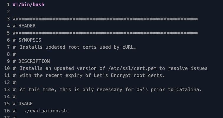

This Automox Worklet™ refreshes the system-wide root certificate bundle that cURL and other OpenSSL-backed tools read from /etc/ssl/cert.pem on macOS endpoints running Mojave (10.14) or earlier. The Worklet downloads the current bundle from the LibreSSL portable project on GitHub, backs up the existing file to /etc/ssl/cert.BAK, and writes the new bundle in place. After the swap, it runs an openssl s_client probe against api.automox.com to confirm the trust chain validates end to end.
The Worklet targets a known operational gap: Apple stopped shipping certificate store updates for older macOS releases, so endpoints stuck on High Sierra, Mojave, or earlier carry a static cert.pem that still trusts the expired DST Root CA X3. That root was the historical anchor of the Let's Encrypt chain, and its September 2021 expiry broke HTTPS for any tool relying on the OpenSSL bundle. The Worklet replaces the stale bundle with the LibreSSL maintained version so the chain validates against ISRG Root X1 and other modern roots.
The evaluation phase is conservative. It reads the Darwin kernel major version and exits zero on Darwin 19 or later, because Catalina and newer endpoints receive certificate store updates from Apple and do not need the Worklet. It also parses the OpenBSD version stamp inside /etc/ssl/cert.pem and exits zero when the on-disk bundle is already at 1.24 or later. Only Mojave or earlier endpoints with a stale bundle are flagged for remediation.

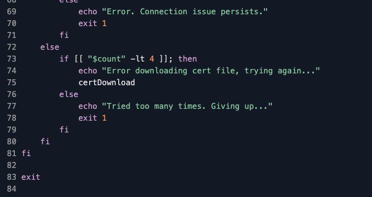

  2. Remediation phase: The script re-checks the Darwin version and refuses to run on Catalina or later. On Mojave or earlier, it downloads the current cert.pem from https://raw.githubusercontent.com/libressl-portable/openbsd/master/src/lib/libcrypto/cert.pem into /tmp/cert.pem using curl -ksS, then moves the existing /etc/ssl/cert.pem to /etc/ssl/cert.BAK and promotes the new file into place. If the first download fails, the script retries it once before giving up. Once the swap completes, the script calls openssl s_client -connect api.automox.com:443 and greps for Verify return code: 0 (ok) to confirm the new bundle resolves the Automox API chain. A failed verification returns exit code 1 so the failure shows up in Automox activity logs.
