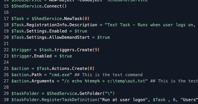

The remediation script constructs a new task with logon trigger type 9 (TASK_TRIGGER_LOGON), attaches an executable action with the command path and arguments you specify, and registers the task in the root task folder. The task is registered against the local Users group with TASK_LOGON_GROUP semantics, which is what lets the action run in the signed-in user's profile instead of the SYSTEM context. The default task name is Run at user logon, and the default action is a sample cmd.exe call that writes the user's TEMP path to c:\temp\out.txt for verification.

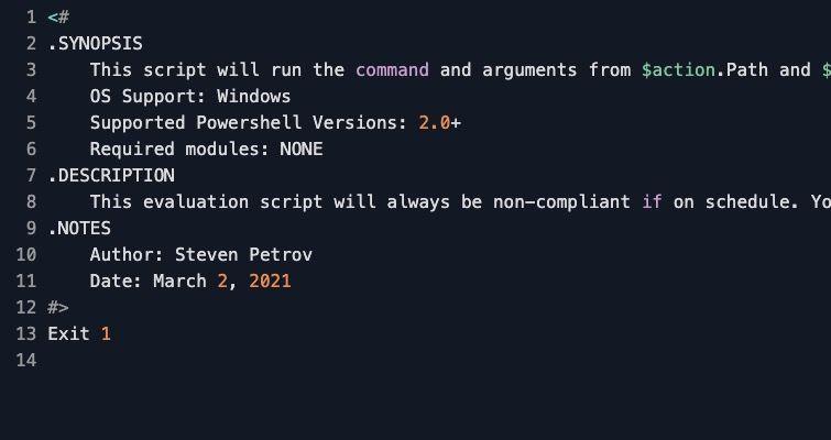

Edit the $action.Path and $action.Arguments variables in remediation.ps1 to point at the executable, script interpreter, or binary you want to run at logon. The evaluation script always returns exit code 1, so the Worklet recreates the task definition on every policy run. The registered task is re-asserted if a user with local admin, a profile reset, or a competing GPO removes it. A recurring weekly cadence keeps the definition current without surfacing changes to signed-in users.

  1. Evaluation phase: The evaluation script unconditionally returns exit code 1, marking the endpoint non-compliant on every run. That forces the Automox agent to invoke remediation each time the policy executes, so the task definition is rebuilt rather than checked. The registration call is idempotent under TASK_CREATE_OR_UPDATE, so every policy run acts as a self-healing assertion of the task's state.
  2. Remediation phase: The remediation script calls New-Object -ComObject Schedule.Service and connects to the local Task Scheduler service. It instantiates a task with NewTask(0), sets RegistrationInfo.Description, and enables Settings.Enabled and Settings.AllowDemandStart. It then creates a logon trigger with Triggers.Create(9) and an executable action with Actions.Create(0), assigning your $action.Path and $action.Arguments values. Finally it calls RegisterTaskDefinition on the root folder with flags 6 (TASK_CREATE_OR_UPDATE) and logon type 4 (TASK_LOGON_GROUP) against the Users principal, registering the task as Run at user logon.
