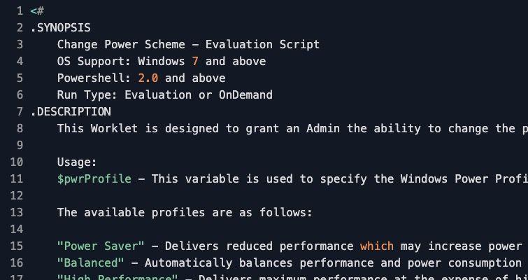

This Automox Worklet™ enforces the active Windows power profile on each endpoint. The Worklet queries the Win32_PowerPlan CIM class under the root\cimv2\power namespace, confirms that the requested profile exists, and activates it with powercfg.exe when it is present but not currently in use. The evaluation phase is idempotent, so endpoints that already match the policy report as compliant without touching configuration.
Windows ships three built-in power profiles. Power Saver reduces CPU performance and shortens display and disk timeouts to stretch battery life. Balanced scales performance against demand on the fly. High Performance pins the CPU at higher frequencies and disables aggressive power-saving behavior. OEM laptops and workstations often ship additional profiles, and administrators can author custom ones with powercfg /create. The Worklet handles any profile name the endpoint exposes, not only the three built-ins.
Profile names are case-sensitive. If the value of $pwrProfile does not match an ElementName on the endpoint, the script lists every available profile in its output. An admin can then correct the policy without having to RDP to the endpoint. The remediation script returns exit code 2 on any failure path. Failures surface as a failed activity in Automox rather than silent drift.

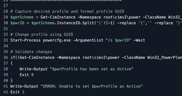

  1. Evaluation phase: The script runs Get-CimInstance -Namespace root\cimv2\power -ClassName Win32_PowerPlan -Filter "ElementName='$pwrProfile'" to locate the requested profile. If the result is null, the script enumerates every Win32_PowerPlan instance, prints the available ElementName values, and exits 2. If the profile exists and its IsActive property is true, the endpoint exits 0 as compliant. If the profile exists but IsActive is false, the endpoint is flagged for remediation.
  2. Remediation phase: The script extracts the GUID segment from InstanceID and strips the surrounding braces. It then runs powercfg.exe /s <GUID> through Start-Process so the exit code can be captured. After a two-second sleep to let Windows commit the change, the script re-queries Win32_PowerPlan and confirms IsActive on the requested profile. On confirmation, the script writes SUCCESS to output and exits 0. The script exits 2 when powercfg returns a non-zero code, when the GUID cannot be extracted, or when the post-change validation fails.
