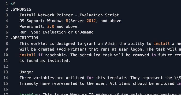

What the network printer deployment Worklet does
This Automox Worklet™ installs a shared network printer on Windows endpoints by registering a logon-triggered scheduled task that runs Add-Printer -ConnectionName \\<prntSvr>\<shareName> in the user's session. You set three policy variables: $prntSvr (the print server name or IP, no backslashes), $shareName (the printer's share name), and $fName (a friendly-name fragment used for matching, with wildcards applied automatically).

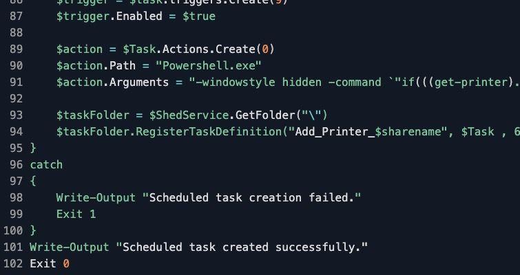

The scheduled task is named Add_Printer_<shareName> and is registered at the root task path with PowerShell.exe -WindowStyle Hidden -EncodedCommand <Base64>. The Base64 encoding (added in version 1.0.3) is what lets share names with spaces and special characters survive the schtasks command line. The task runs as the built-in Users group with logon trigger type 9, so each interactive user picks up the printer on their next sign-in.
The Worklet is self-cleaning. Once Get-Printer on the endpoint shows the configured share installed, the next remediation cycle unregisters the scheduled task so it does not keep re-running at every logon for the life of the endpoint.

  1. Evaluation phase: Get-Printer is called and the results are filtered for ComputerName -like $prntSvr and Name -like *$fName*. If the printer is installed and the Add_Printer_<shareName> scheduled task is still present, the endpoint is flagged for cleanup (exit 2). If the printer is installed and no task exists, the endpoint is compliant (exit 0). If the printer is missing, the endpoint is flagged for remediation (exit 2).
  2. Remediation phase: When the printer is already installed and the task lingers, Unregister-ScheduledTask removes Add_Printer_<shareName>. When the printer is missing, the script builds a PowerShell payload that runs Add-Printer -ConnectionName \\$prntSvr\$shareName after a Test-Connection reachability check, Base64-encodes the payload, and registers it through the Schedule.Service COM object with a logon trigger (type 9) and the Users principal. The task is created at the root task folder with RegisterTaskDefinition(..., 6, "Users", $null, 4).
