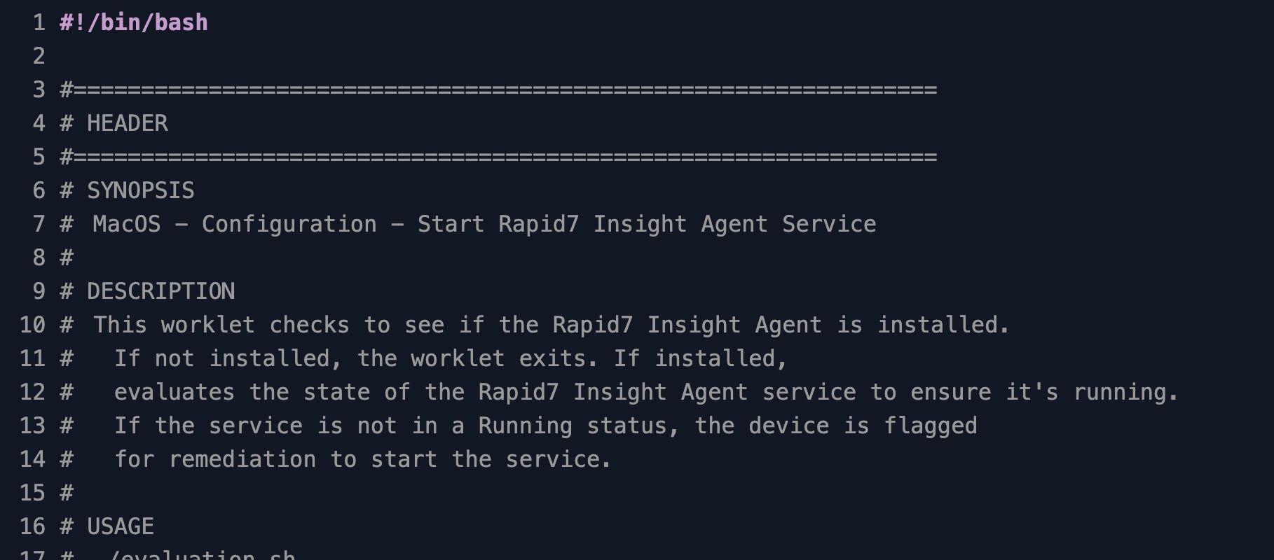

This Automox Worklet™ keeps the Rapid7 Insight Agent service running on macOS endpoints. The Worklet inspects the LaunchDaemon registry for com.rapid7.ir_agent, confirms the ir_agent process is alive, and triggers a restart through launchctl when the daemon is registered but not running. The evaluation phase is read-only, so endpoints that already have a healthy agent finish in milliseconds.

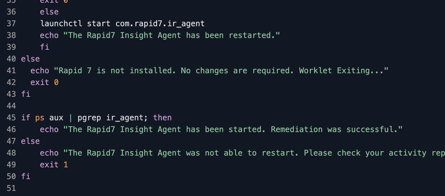

The Rapid7 Insight Agent on macOS installs into /opt/rapid7/ir_agent/ and registers a system LaunchDaemon at /Library/LaunchDaemons/com.rapid7.ir_agent.plist. The remediation script calls launchctl start com.rapid7.ir_agent against that label, then re-checks the process list with pgrep ir_agent before exiting. A restart that fails returns a non-zero exit code, which surfaces in the Automox activity report instead of being silently swallowed.
Endpoints where Rapid7 is not installed exit cleanly with no changes. That means the policy can sit on a daily cadence alongside the Rapid7 install Worklet, since the absence of the agent is treated as out-of-scope rather than a remediation failure on hosts that legitimately have not yet been onboarded to InsightVM.

  1. Evaluation phase: The evaluation script pipes launchctl list through grep com.rapid7.ir_agent to check whether the LaunchDaemon is registered. If the label is missing, the endpoint is reported as out-of-scope and the script exits 0 with no remediation queued. If the label is registered, the script runs pgrep ir_agent to confirm the process is alive. A running process exits 0; a registered-but-stopped daemon exits 1 and flags the endpoint for remediation.
  2. Remediation phase: The remediation script re-validates the daemon registration, then runs launchctl start com.rapid7.ir_agent against the LaunchDaemon label. After the start command, it re-runs pgrep ir_agent to confirm the process attached. Exit 0 is a successful restart; exit 1 indicates launchctl returned but the process never came up, which usually points to a corrupt agent install, a missing plist, or another security tool blocking the daemon. The non-zero exit pushes the endpoint into the Automox failed-policy queue for review.

After a successful remediation, launchctl list | grep com.rapid7.ir_agent returns a PID in the first column, and pgrep ir_agent emits the same PID. The agent re-establishes its connection to the Rapid7 Insight platform and resumes sending vulnerability telemetry. Subsequent Automox policy runs evaluate the endpoint as compliant and skip remediation, because the evaluation script finds the daemon registered and the process running.
If the remediation phase exits 1 repeatedly on the same endpoint, the agent install is likely corrupt. Run the matching uninstall Worklet, redeploy with the install Worklet, and let this Worklet take over enforcement on the next policy cycle.
