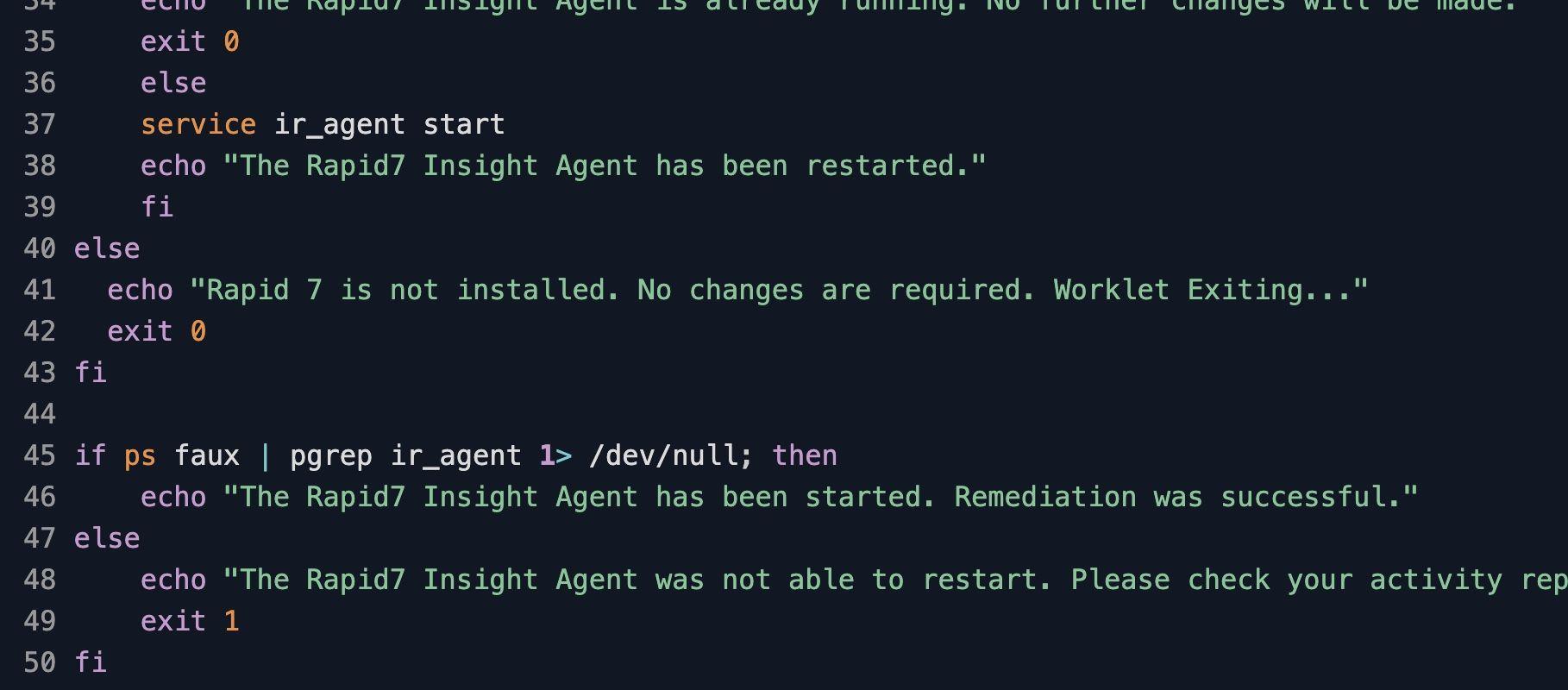

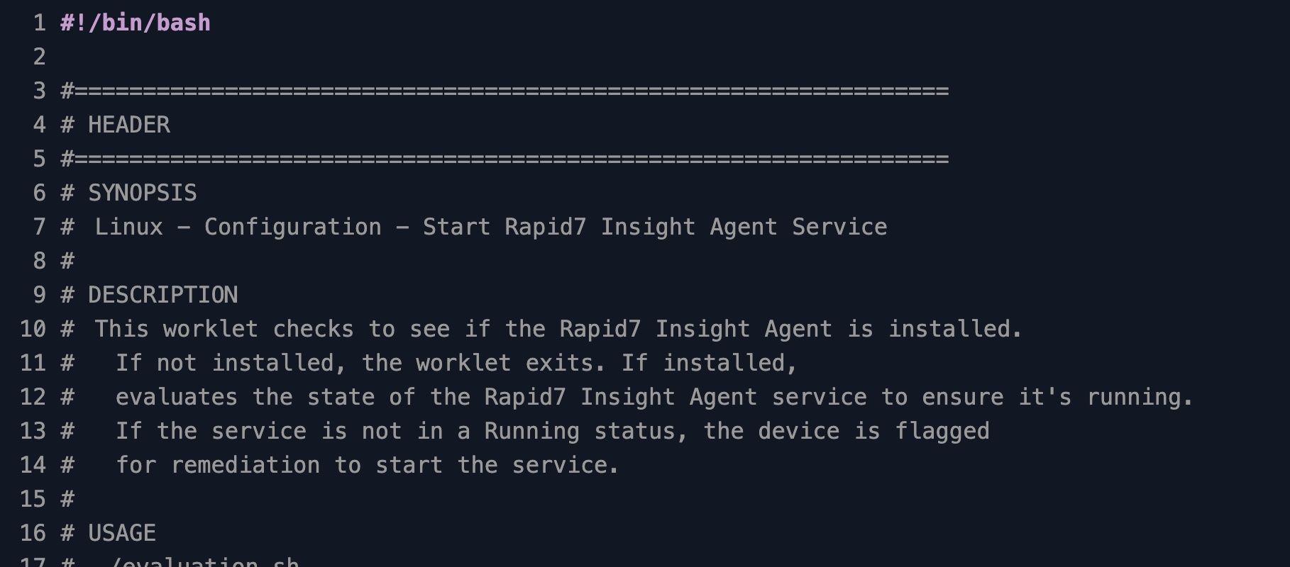

This Automox Worklet™ starts the Rapid7 Insight Agent service on Linux endpoints when the ir_agent daemon is stopped or unresponsive. The Worklet first checks whether ir_agent is registered in systemd by running systemctl list-unit-files and grepping for ir_agent. If no matching unit is found, the Worklet exits without modifying anything, so the policy can target a mixed Linux estate where Rapid7 onboarding is still in progress without producing remediation noise on hosts that do not run ir_agent yet.
When the unit is registered, the Worklet evaluates whether the daemon is actually running by piping ps faux through pgrep ir_agent. If the process is found, evaluation passes and no changes are made. If pgrep finds no running ir_agent process, the endpoint is flagged for remediation.
The remediation path runs service ir_agent start. After issuing the start command, the Worklet re-runs the pgrep probe to confirm the daemon came back up. If the process is still absent, the Worklet exits with a non-zero code and the failure surfaces in the Automox activity log for triage.

  1. Evaluation phase: The Worklet runs systemctl list-unit-files and greps for ir_agent to determine whether the agent is registered with systemd. If no unit is found, evaluation exits 0 and remediation is skipped. If the unit is registered, the Worklet pipes ps faux through pgrep ir_agent. The endpoint passes evaluation only when a live ir_agent process is found. A missing process flags the endpoint for remediation.
  2. Remediation phase: The Worklet runs service ir_agent start to bring the daemon back up. It then re-runs the pgrep ir_agent probe to confirm the process is alive. On success, the Worklet exits 0 and the next evaluation pass reports the endpoint compliant. On failure, the Worklet exits non-zero and the activity log records the output for triage.
