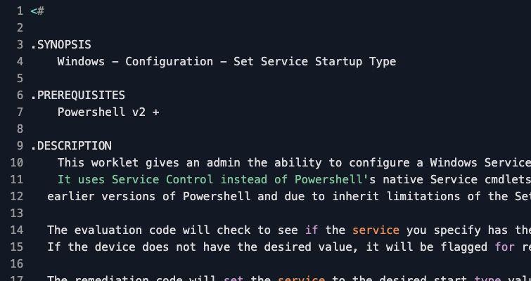

This Automox Worklet™ enforces the startup type of a named Windows service on every endpoint in scope. You set the service name and one of four target states – Automatic, DelayedAutoStart, Manual, or Disabled – and the Worklet rewrites the SCM record on any endpoint where the running START_TYPE has drifted. The script drives sc.exe directly rather than Set-Service, which keeps it working on PowerShell 2.0 hosts and avoids the long-standing Set-Service gap around DelayedAutoStart.
The evaluation script reads the current configuration with sc.exe qc <service>, parses the START_TYPE field, and normalizes the raw values (AUTO_START, AUTO_START (DELAYED), DEMAND_START, DISABLED) to the four policy names. When the current state matches the configured target, the endpoint reports compliant and exits 0. When it does not match, the endpoint is flagged and the remediation script runs.
Remediation calls Start-Process sc.exe config <service> start= <auto|delayed-auto|demand|disabled>, then re-queries sc.exe qc to confirm the change applied. The Worklet writes the result to the Automox Activity Log and exits 0 only when the post-run startup type matches the policy target, or exits 1 with the expected and actual values when it does not. A repeat policy run re-evaluates the endpoint and re-applies the configuration if anything (a vendor installer, a GPO refresh, a manual change) has reset it.

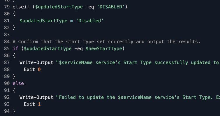

  2. Remediation phase: The script translates the four policy names to the sc.exe argument set (auto, delayed-auto, demand, disabled) through a hashtable lookup. It launches Start-Process -NoNewWindow -FilePath sc.exe -ArgumentList "config $serviceName start= $scStartType" -Wait, then re-runs sc.exe qc to read the post-change state. When the new state matches the target, the Worklet writes a success line to the Automox Activity Log and exits 0. When it does not, the Worklet writes a failure line with the expected and actual values and exits 1, surfacing the failure in policy results rather than masking it.
