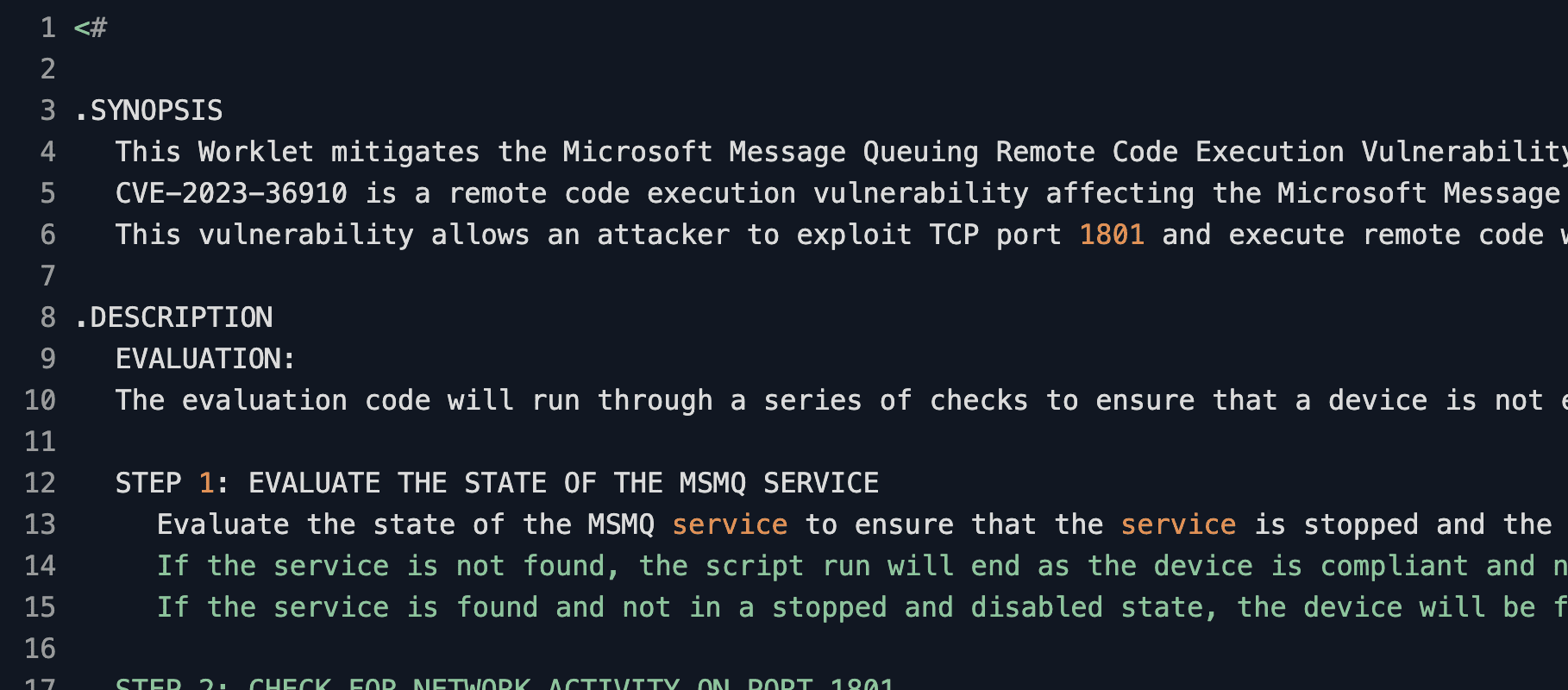

  1. Evaluation phase: The Worklet calls Get-Service -Name MSMQ to determine whether the Message Queuing service is installed. If the service is not present, the endpoint is reported compliant and the script exits 0 without scheduling remediation. If the service exists, the Worklet inspects Status and StartType, queries Get-NetTCPConnection -LocalPort 1801 for an active listener, and runs Get-NetFirewallRule -DisplayName 'AUTOMOX WORKLET: Block TCP 1801' to confirm the block rule exists and is enabled. The endpoint is flagged non-compliant (exit 2) if the service is running, the StartType is anything other than Disabled, an active listener is detected on TCP 1801, or the firewall rule is missing or disabled.

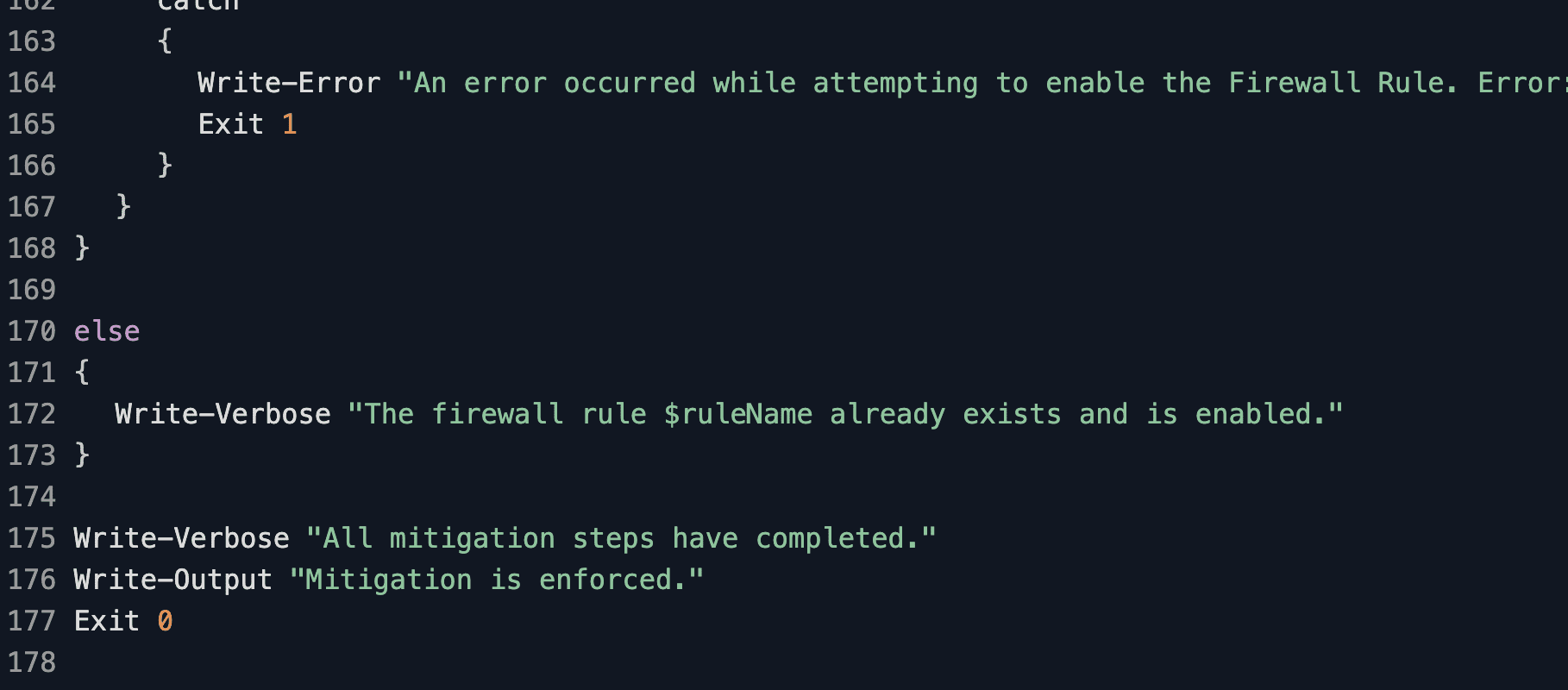

  2. Remediation phase: The remediation script runs Stop-Service -Name MSMQ -Force followed by Set-Service -Name MSMQ -StartupType Disabled, which stops the active process and prevents the service from restarting at boot. It then calls New-NetFirewallRule -DisplayName 'AUTOMOX WORKLET: Block TCP 1801' -Direction Inbound -Protocol TCP -LocalPort 1801 -Action Block to create the inbound block rule. If a rule with that display name already exists but is disabled, the script uses Set-NetFirewallRule -DisplayName 'AUTOMOX WORKLET: Block TCP 1801' -Enabled True to re-enable it. The script exits 0 on success and writes Write-Error with exit code 1 if any step fails.

After a successful run, Get-Service MSMQ reports Status: Stopped and StartType: Disabled, and Get-NetTCPConnection -LocalPort 1801 returns no listener. Get-NetFirewallRule -DisplayName 'AUTOMOX WORKLET: Block TCP 1801' returns an Enabled inbound rule with Action Block on TCP 1801. The Worklet does not uninstall the MSMQ Windows feature; if you want to remove the binaries from disk, follow up with a separate policy that runs Disable-WindowsOptionalFeature.
Subsequent Automox policy runs report the endpoint as compliant without re-running remediation, because the evaluation phase finds the service disabled, the port closed, and the firewall rule in place. To validate at the network layer, run Test-NetConnection -ComputerName <endpoint> -Port 1801 from a peer host and confirm the result is TcpTestSucceeded: False. For audit evidence, capture the output of Get-Service MSMQ, Get-NetFirewallRule -DisplayName 'AUTOMOX WORKLET: Block TCP 1801' | Format-List *, and the Automox activity log entry, and attach them to the MSMQ remediation ticket. The mitigation persists across reboots and Windows feature updates because the firewall rule and service start mode are stored in the registry, not in volatile state.
