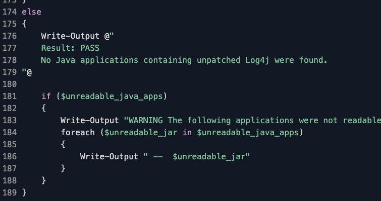

Results land in the Automox console activity log in three states. A PASS line means no vulnerable archives were found. A FAIL block lists every vulnerable path with CVE-2021-44228 and CVE-2021-45046 references attached, and any unreadable archives are appended under a WARNING line. An UNKNOWN result fires when no vulnerable archives were found but at least one archive could not be opened. Common culprits are locked database JARs, files held by another process, and archives sitting in $Recycle.Bin – which the script skips by design when an open fails.

  2. Remediation phase: The remediation script enumerates fixed drives with [System.IO.DriveInfo]::GetDrives() filtered to DriveType Fixed, recursively walks each root with Get-ChildItem -Force -Recurse -ErrorAction SilentlyContinue, and filters to files whose extension is .jar, .war, or .ear. Each archive is opened as a System.IO.FileStream and passed to a System.IO.Compression.ZipArchive reader. The script flags an archive as vulnerable when it contains JndiLookup.class and the matching JndiManager.class does not contain the log4j2.enableJndi string introduced in the patched releases. Nested .jar, .war, and .ear entries are recursed in place. Findings, unreadable paths, and the final PASS, FAIL, or UNKNOWN verdict are written to the Automox activity log. The Worklet is detection-only and does not delete, quarantine, or replace any archive.

Open the Automox activity log for the policy run and look for the Result line. Result: PASS means no archive on any fixed drive carries an unpatched JndiLookup.class. Result: FAIL is followed by a list of full file paths prefixed with `--` – for example, ` -- C:\Program Files\Vendor\lib\application.jar` – each of which contains JndiLookup.class without the patched JndiManager marker, plus a WARNING block listing any archives that could not be read. Result: UNKNOWN appears when no vulnerable archives were found but at least one archive could not be opened, and the unreadable paths are listed underneath.
