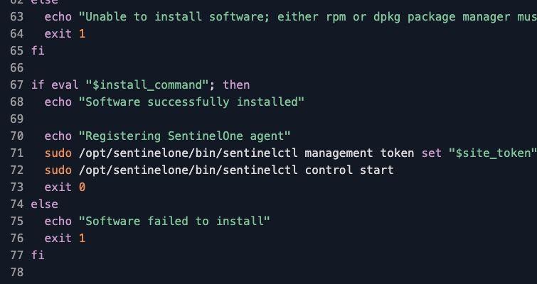

After the package install completes, the Worklet writes the site token through sentinelctl management token set and starts the agent service with sentinelctl control start, both called from /opt/sentinelone/bin/. The endpoint then registers as a managed asset, begins streaming telemetry, and starts enforcing the policy assigned to it in the SentinelOne console.

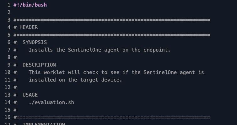

  1. Evaluation phase: The evaluation script runs sudo sentinelctl version and inspects the exit code. Exit 0 means the SentinelOne agent is installed and the sentinelctl binary is responsive, so the endpoint is reported compliant and remediation is skipped. A non-zero exit or a missing sentinelctl on PATH flags the endpoint for remediation. The check completes in under a second, so a recurring policy can sit alongside the rest of your EDR-coverage Worklets without operational cost.
  2. Remediation phase: The remediation script re-checks sentinelctl version and exits early if the agent is already present. Otherwise it detects the package manager using command -v dpkg and command -v rpm. On Debian and Ubuntu hosts it runs sudo dpkg -i against the staged .deb file referenced by the deb_filename variable; on RHEL, CentOS, Rocky, Alma, and Fedora hosts it runs sudo rpm -i --nodigest against the .rpm referenced by the rpm_filename variable. After install, the script calls sudo /opt/sentinelone/bin/sentinelctl management token set <site_token> to register the agent with your SentinelOne console, then sudo /opt/sentinelone/bin/sentinelctl control start to bring the agent up. A non-zero exit anywhere in the chain surfaces in the Automox activity log so failures do not go silent.
