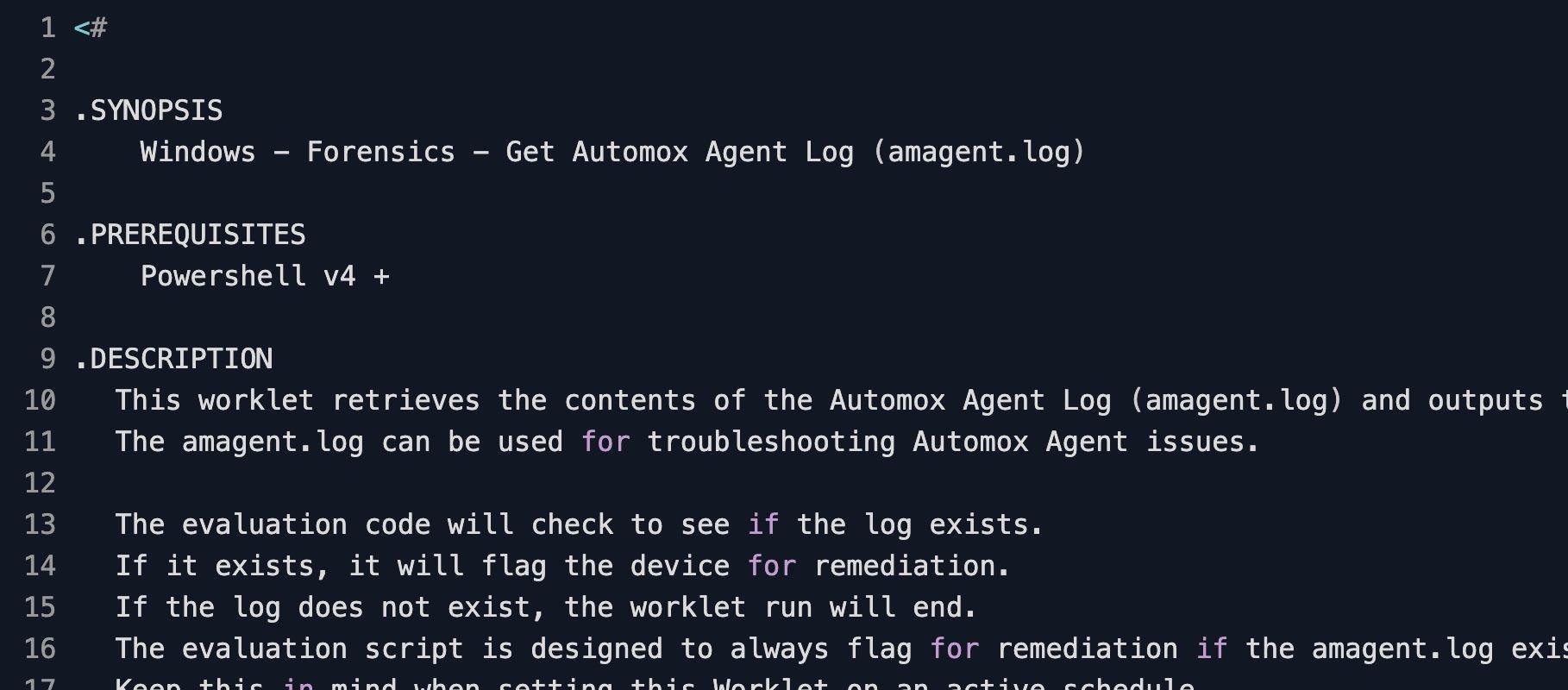

This Automox Worklet™ reads the amagent.log file at C:\ProgramData\amagent\amagent.log on Windows endpoints and writes the requested portion of the file to the Automox Activity Log. The amagent.log is the primary diagnostic surface for the Automox Agent. It records policy evaluation runs, Worklet execution, patch scan results, server check-ins, and authentication or network failures with timestamped entries.

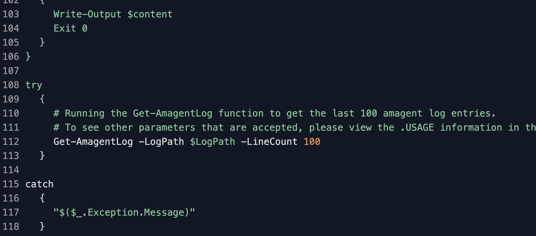

The remediation script defines a Get-AmagentLog PowerShell function with two optional parameters, -LineCount and -DateSearch, which combine to give you four retrieval modes. With no parameters, the function returns the entire log. With -LineCount N, it returns the last N entries. With -DateSearch 'YYYY/MM/DD', it returns every line containing that date string. With both parameters, it returns the last N entries from that date. The default invocation on line 115 pulls the last 100 lines, which keeps output well inside the 1 MB Activity Log ceiling.

  1. Evaluation phase: The Worklet runs Test-Path on C:\ProgramData\amagent\amagent.log with -PathType 'Leaf' to confirm the agent log exists on the endpoint. If the file is present, the script writes a confirmation line to stdout and exits 1 to flag the endpoint for remediation. If the path is missing, the script writes a not-eligible message and exits 0, so the endpoint is skipped without an error state. The evaluation flags any endpoint where the log exists, so account for that behavior when scheduling the policy.
  2. Remediation phase: The remediation script defines the Get-AmagentLog function, then invokes it on line 115 with the parameters you configured. The function re-validates the log path, validates -DateSearch against the regex ^\d{4}/\d{2}/\d{2}$ when supplied, reads the file with Get-Content, optionally filters by date using Where-Object with [regex]::Escape, optionally trims to the last N lines using Select-Object -Last, and writes the resulting lines to stdout. If the filter returns nothing, the function writes 'No log entries were found with your defined search criteria.' and exits 0. The Automox Agent captures stdout into Activity Log output.

  • Edit line 115 of the remediation script to set the parameters you want: -LineCount N for the last N lines, -DateSearch 'YYYY/MM/DD' for a specific day, both parameters together to combine them, or neither to return the full file
