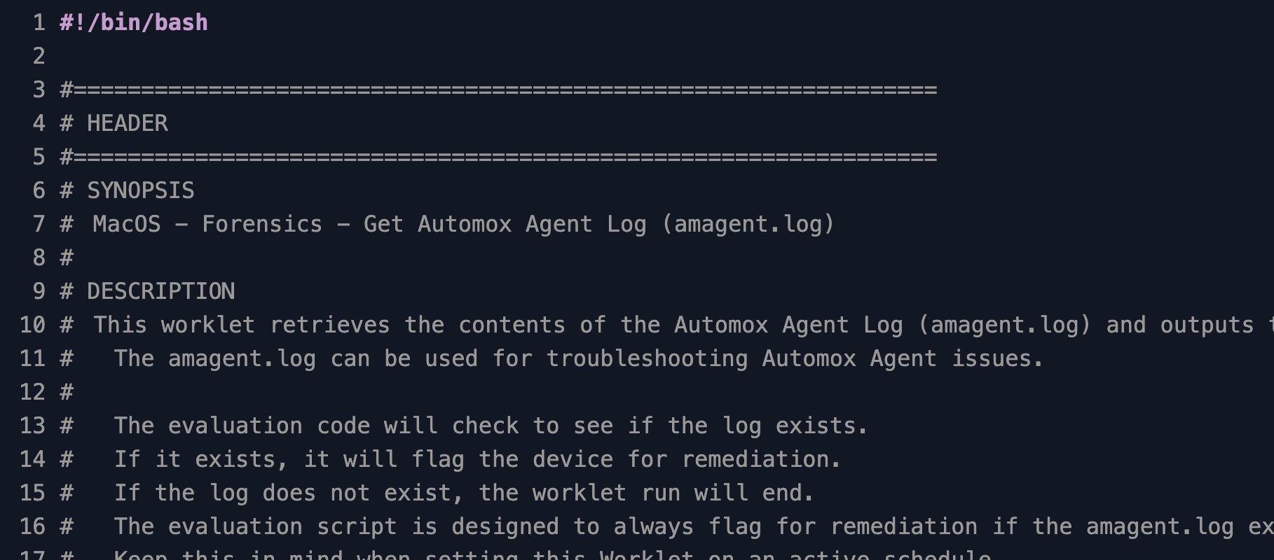

This Automox Worklet™ reads the Automox Agent log on a macOS endpoint and prints the requested portion to the Automox Activity Log for that endpoint. Both the evaluation and remediation scripts target /var/log/amagent/amagent.log, which is where the macOS agent writes its runtime log.
The Worklet exposes four retrieval modes selected by the worklet_mode variable in the remediation script. Mode 1 returns the last N lines with tail -n (default 100, controlled by the desired_line_count variable). Mode 2 streams the entire file with cat. Mode 3 returns every line matching desired_date with grep. Mode 4 narrows mode 3 to the last N matching lines by piping grep into tail.
Modes 3 and 4 read the desired_date variable as a free-text grep pattern against each line of the log. To match the timestamp the agent writes at the start of each entry, pass the date as yyyy/mm/dd. If desired_date is empty when mode 3 or 4 is selected, the script exits 1 with an error message rather than dumping the whole file.

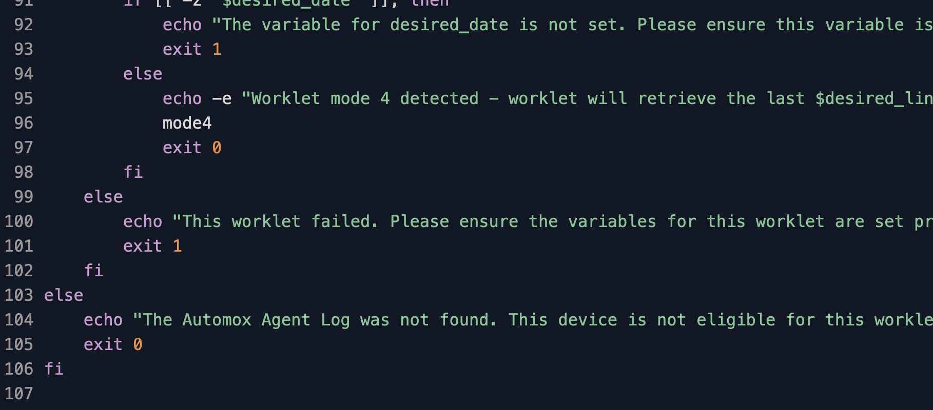

  1. Evaluation phase: The evaluation script tests for /var/log/amagent/amagent.log with a -f file test. If the log file exists, the script exits 1 and the endpoint is flagged for remediation. If the file is missing, the script exits 0 and the endpoint is reported as not eligible, so the Worklet quietly skips Macs that have no agent log to retrieve.
  2. Remediation phase: The remediation script reads worklet_mode and dispatches to one of four commands against /var/log/amagent/amagent.log. Mode 1 runs tail -n "$desired_line_count". Mode 2 runs cat. Mode 3 runs grep "$desired_date". Mode 4 runs grep "$desired_date" | tail -n "$desired_line_count". Modes 3 and 4 exit 1 if desired_date is unset. The output is written to stdout, which the Automox Agent collects and posts to the endpoint's Activity Log entry for that policy run.

  • Set desired_date in yyyy/mm/dd format for modes 3 and 4 (matches the timestamp prefix the agent writes; the variable is uncommented and assigned in the User Variables block, or modes 3 and 4 will exit with an error)
