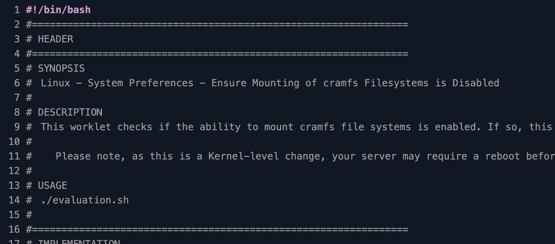

This Automox Worklet™ blocks the Linux kernel from mounting the cramfs compressed read-only filesystem. The Worklet writes /etc/modprobe.d/cramfs.conf with the directive install cramfs /bin/true, which tells modprobe to run /bin/true instead of loading the cramfs module the next time the kernel asks for it. If cramfs is already loaded on the running host, the Worklet also calls rmmod cramfs so the change takes effect immediately rather than at the next reboot.
The Worklet runs across RHEL, CentOS, Rocky, Alma, Fedora, Ubuntu, and Debian endpoints under the Automox agent. It uses only base utilities (lsmod, modprobe, rmmod, and a shell redirect to write the conf file), so there is no package manager dependency and no distribution-specific code path. The evaluation phase is idempotent: hosts that already have the install override staged report compliant and skip remediation entirely.

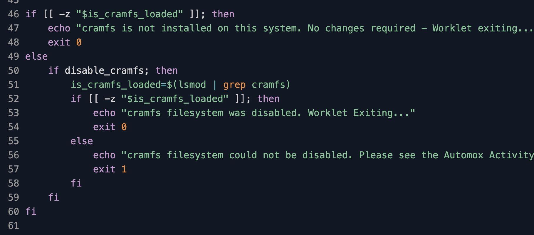

  1. Evaluation phase: The Worklet first runs modprobe -n -v cramfs to confirm the kernel actually has a cramfs module path to load. If modprobe reports the module is not installed, the script exits 0 and the host reports compliant with no further action. If cramfs is installed, the Worklet then runs lsmod | grep cramfs to test whether the module is loaded on the running kernel. An empty result exits 0 as compliant; a non-empty result exits 1 and schedules remediation.
  2. Remediation phase: When cramfs is loaded, the remediation script touches /etc/modprobe.d/cramfs.conf and writes the line install cramfs /bin/true to it, then calls rmmod cramfs to unload the module from the running kernel. After unloading, the script re-runs lsmod | grep cramfs to confirm the module is gone, exiting 0 on success and 1 with stderr captured in the Automox activity log if the unload failed. The persistent conf file blocks future modprobe cramfs invocations, including the indirect ones triggered by mount -t cramfs, and the live rmmod removes the in-memory copy so the change does not depend on a reboot.
