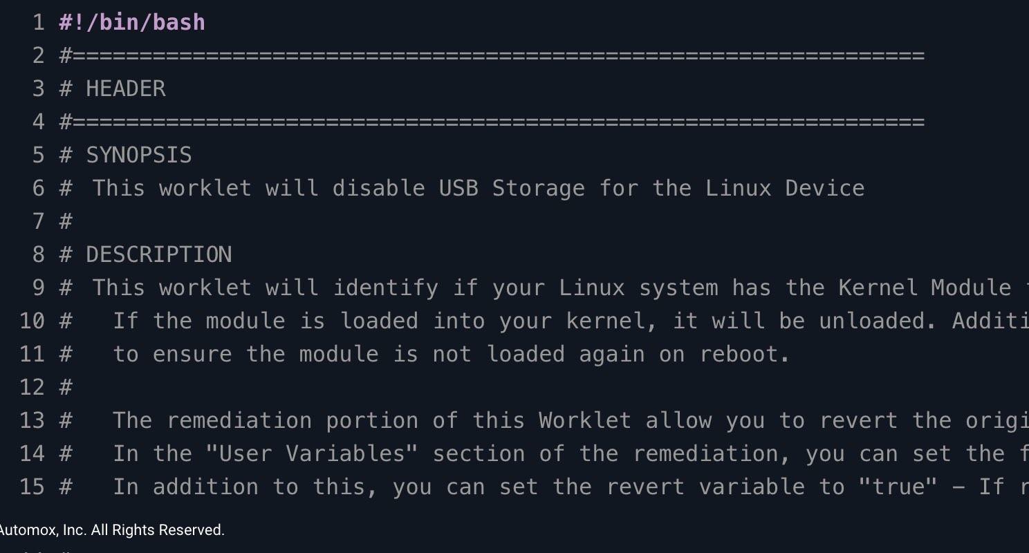

This Automox Worklet™ disables the usb-storage kernel module on Linux endpoints so USB mass storage devices stop mounting. The Worklet first uses lsmod to detect whether the running kernel has usb-storage or usb_storage loaded. When the module is loaded, the endpoint is flagged for remediation and the policy moves the host back into a compliant state.
Remediation writes a modprobe configuration file to /etc/modprobe.d/ax-usb-storage.conf containing the line install usb-storage /bin/true. That single directive redirects every future load attempt for the usb-storage module to /bin/true, which exits 0 without loading any code. The Worklet then runs rmmod usb-storage to unload the module from the running kernel so the change takes effect immediately, not just at the next reboot.
Before writing the new rule, the script sweeps /etc/modprobe.d/ for any existing files that reference usb-storage or usb_storage and strips the conflicting lines with sed. The configuration filename is parameterized through the module_config_file_name input, defaulting to ax-usb-storage.conf so the Automox-managed rule is easy to spot in an audit. A revert path in the same remediation script removes the blocking file and runs modprobe usb-storage when an administrator needs to temporarily re-enable removable media on a specific endpoint.

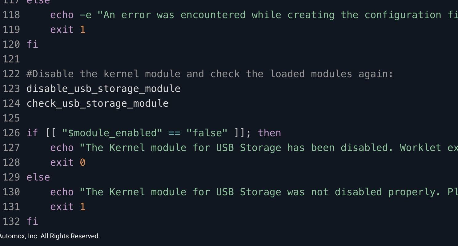

  2. Remediation phase: The remediation script reads the module_config_file_name parameter, scrubs any existing usb-storage or usb_storage references from files in /etc/modprobe.d/, and writes install usb-storage /bin/true to /etc/modprobe.d/ax-usb-storage.conf. It then runs rmmod usb-storage to unload the active module and re-checks lsmod. The script exits 0 when the module is gone, or exits 1 with a message in stderr if the rule could not be written or the module refuses to unload.
