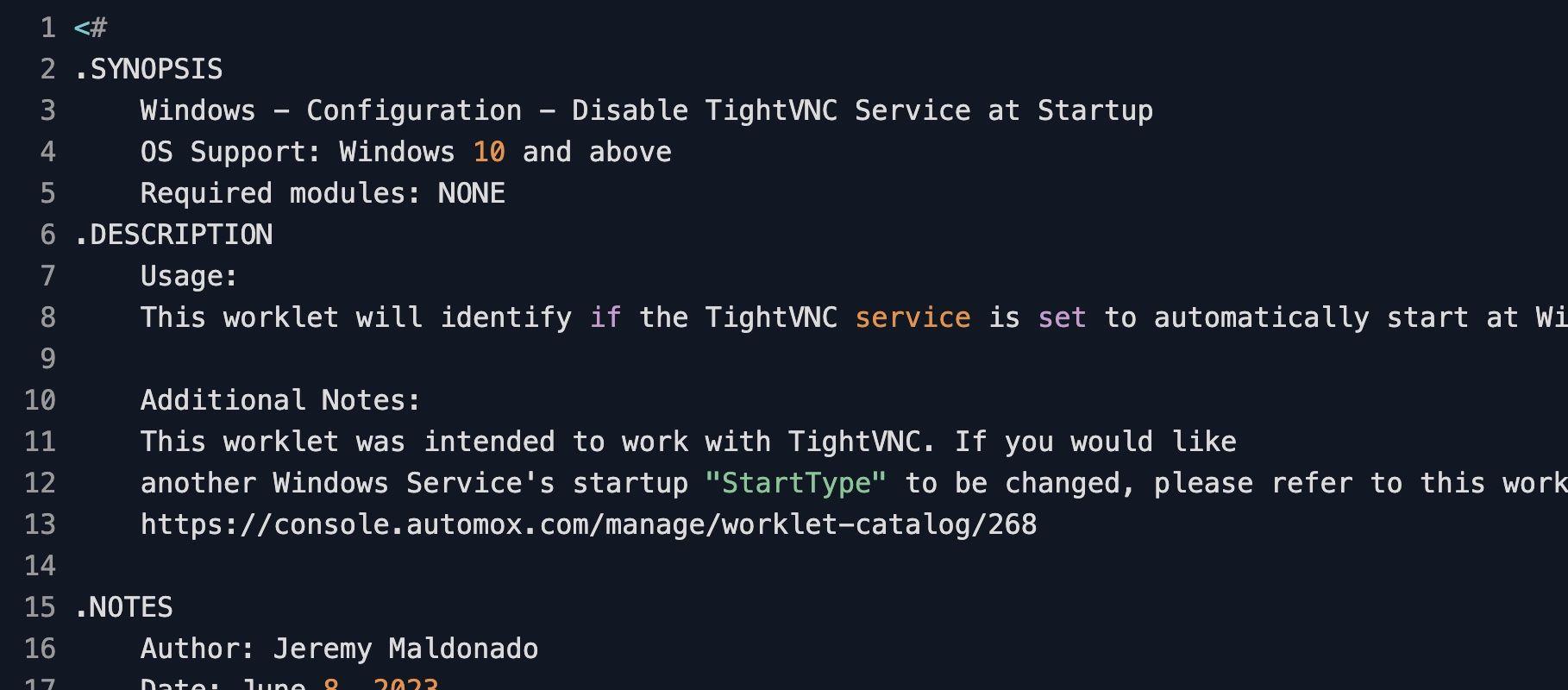

Disable TightVNC tvnserver auto-start on Windows endpoints by switching the service from Automatic to Manual
What the TightVNC startup blocker does
This Automox Worklet™ prevents the TightVNC tvnserver service from launching at Windows boot. A default TightVNC Server install registers tvnserver with a StartType of Automatic, which means the VNC listener binds to TCP 5900 on every reboot whether an administrator is actively using it or not.
The Worklet flips that StartType to Manual so the service is available on demand but is no longer a persistent network-facing listener. Endpoints without tvnserver installed are skipped, and endpoints already set to Manual or Disabled are left alone, so the policy is safe to run across a mixed Windows fleet.

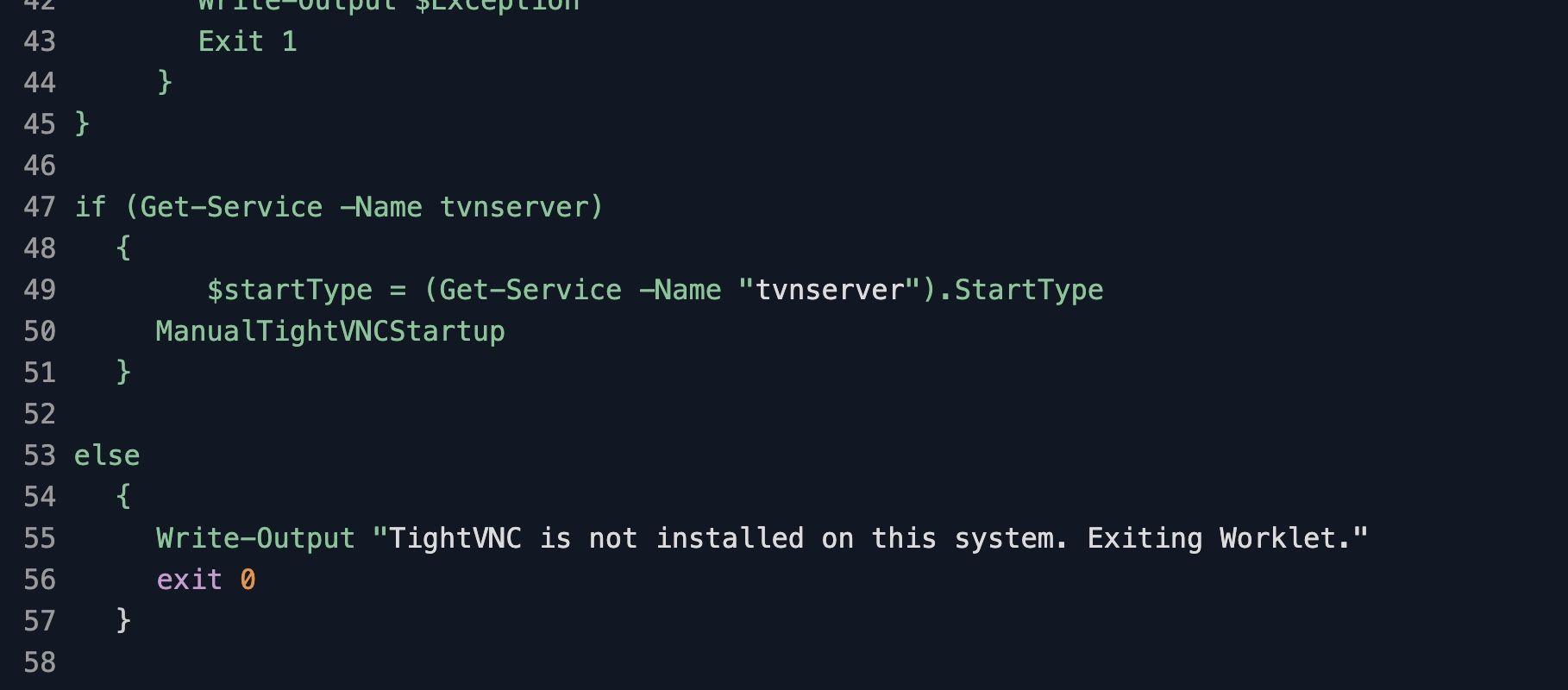

  1. Evaluation phase: The Worklet runs Get-Service -Name tvnserver to confirm the service exists. If the service is missing, the endpoint exits 0 and is treated as compliant, because there is no TightVNC listener to harden. If the service exists, the script reads its StartType. A StartType of Automatic triggers a non-zero exit, and Automox schedules remediation. A StartType of Manual or Disabled exits 0 and the endpoint is left alone.
  2. Remediation phase: The remediation script re-reads the StartType inside a try/catch and calls Set-Service -Name tvnserver -StartupType Manual when the value is still Automatic. Set-Service writes the change through the Service Control Manager, which updates the underlying registry value at HKLM:\SYSTEM\CurrentControlSet\Services\tvnserver\Start. On failure, the catch block emits the exception message and the failing script line number to the Automox activity log and exits 1, so a permissions error never fails silently. On success the script exits 0 and the change applies at the next boot.
