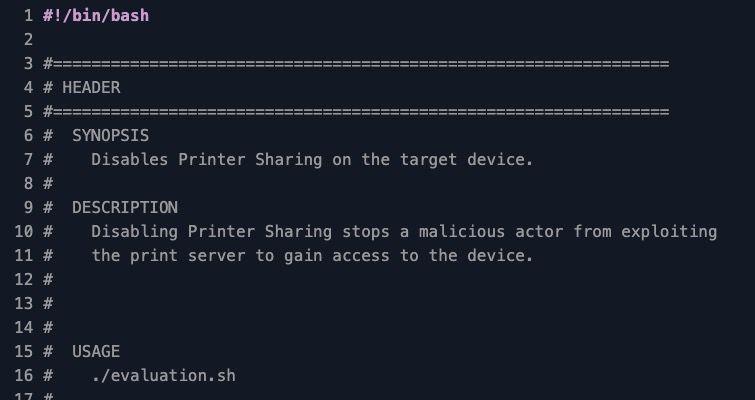

This Automox Worklet™ turns off the macOS Printer Sharing service by toggling the CUPS _share_printers flag. The Worklet shells out to cupsctl, parses the current value of the flag, and treats anything other than 0 as a non-compliant state. When sharing is on, the remediation script runs cupsctl --no-share-printers to close the IPP listener and stop the endpoint from accepting print jobs from other hosts.

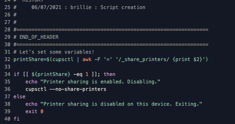

  1. Evaluation phase: The Worklet runs cupsctl and pipes the output through awk -F '=' to extract the _share_printers field. A value of 1 means the CUPS daemon is accepting remote print jobs, so the script echoes a remediation message and exits 1 to mark the endpoint non-compliant. A value of 0 (or an absent field on a freshly installed system) exits 0 and leaves the endpoint alone.
  2. Remediation phase: The remediation script re-reads _share_printers (in case the state changed between policy evaluation and execution), and when it is still 1, runs cupsctl --no-share-printers. The cupsctl call rewrites the relevant directives in /etc/cups/cupsd.conf and signals the cupsd process to reload, which drops the TCP 631 listener and removes the Bonjour advertisement without requiring a manual launchctl bootout or a reboot.

Verify on a sample endpoint by running cupsctl | grep _share_printers and confirming the value is 0. As a network-side check, run lsof -iTCP:631 -sTCP:LISTEN on the endpoint (or nmap -p 631 from a peer host on the same VLAN) and confirm cupsd is no longer bound on the public interface. For audit evidence, capture the cupsctl output and the Automox policy run identifier together; both surface in activity logs and exit code 0 from the evaluation script is the canonical signal that the endpoint is in the desired state. If the next policy cycle finds the flag flipped back on, the Worklet will quietly re-disable it without operator intervention.
