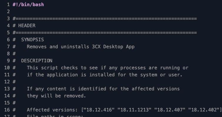

This Automox Worklet™ detects and removes trojanized builds of the 3CX Desktop App from macOS endpoints. The Worklet scans the four locations where the 3CX installer drops the app bundle and reads the version string out of Spotlight metadata using mdls and the kMDItemVersion attribute. It then matches each on-disk version against the four builds tied to the March 2023 supply-chain compromise: 18.12.416, 18.11.1213, 18.12.407, and 18.12.402.
When a match is found, the Worklet terminates any running 3CX Desktop App process, deletes the application bundle, and removes the associated Application Support directories that the trojanized installer drops outside the bundle. Clean installs on any other version are left in place, so the Worklet is safe to run across a mixed fleet without disrupting endpoints that already updated to a patched build.

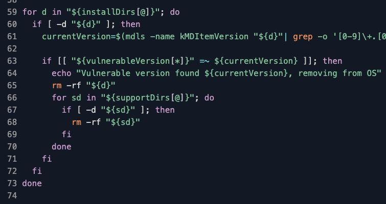

  1. Evaluation phase: The Worklet enables case-insensitive globbing with shopt -s nocaseglob, then runs pgrep against the pattern .*3cx.*desktop.* to detect a live 3CX Desktop App process. If a process is running, the evaluation exits non-compliant. With no live process, the Worklet iterates the four install paths (/, /Applications/, /Users/*/Applications/, and /Users/*/Desktop/) for any bundle matching 3cx*desktop*.app. For each bundle found, it reads kMDItemVersion via mdls and compares the value against the affected list (18.12.416, 18.11.1213, 18.12.407, 18.12.402). A match returns exit code 1 and flags the endpoint for remediation.
  2. Remediation phase: The remediation script re-runs the same discovery, then escalates. Running 3CX processes are killed with pgrep piped to xargs kill -9 so the bundle is not held open by the file system. The Worklet removes any matched bundle with rm -rf, then walks the support directories /Library/Application Support/3cx*desktop*.app and /Users/*/Library/Application Support/3cx*desktop*.app to delete the persistence files the trojanized installer drops outside the app bundle. Bundles on a non-affected version are left untouched.
