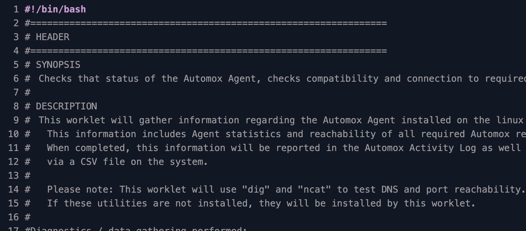

This Automox Worklet™ captures a structured connectivity and service health snapshot of the Automox agent on a Linux endpoint and writes the results to the Automox activity log and a timestamped CSV on the endpoint. The Worklet inspects amagent.service with systemctl, walks the routing table with ip route get, resolves every host in the Automox agent firewall allowlist with dig, and tests TCP port reachability with nc -zv. The combined output is enough for a support engineer to triage a connectivity issue without opening an SSH session to the host.
The Worklet records the amagent service install state, runtime status, boot-enabled state, supported OpenSSL TLS versions, default route next hop, route to the resolved api.automox.com address, DNS A records for automox.com, api.automox.com, the LaunchDarkly endpoints (app, clientstream, events), digicert.com, cdn.digicertcdn.com, and automox-policy-files.s3.us-west-2.amazonaws.com, and TCP reachability for those same hosts on ports 80 and 443. Each check is tagged Pass or Fail in the CSV at /var/lib/amagent/diagnostic_worklet_results/automox_diagnostics.<timestamp>.csv.
The Worklet runs from the Devices page, the Run Policy option, or FixNow. Automox recommends against scheduling this diagnostic because the CSV output is most useful when correlated to a specific support ticket. The script also installs dig (bind-utils) and nc (nmap or nmap-ncat) on demand using yum or apt-get if either tool is missing, so the diagnostic still returns a complete result on a minimal base image.

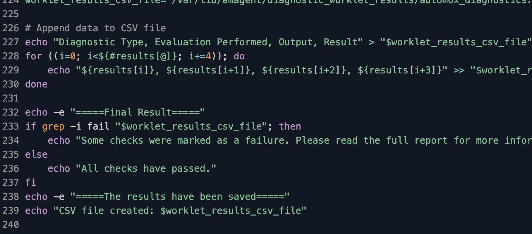

  2. Remediation phase: The Worklet installs dig and nc on demand, then runs systemctl list-unit-files, systemctl status, and systemctl is-enabled against amagent.service, captures default and api.automox.com routing with ip route get, checks supported TLS via openssl ciphers -v, resolves each allowlisted host with dig A, tests TCP 80 and 443 reachability with nc -zv, and tails the last LogLines (default 15) entries of /var/log/amagent/amagent.log. Results are echoed to the policy output and written to /var/lib/amagent/diagnostic_worklet_results/automox_diagnostics.<timestamp>.csv.

After the Worklet runs, the Automox activity log and the on-endpoint CSV contain a four-column table (Diagnostic Type, Evaluation Performed, Output, Result) with one row per check across Service Evaluation, Network Evaluation, and Data Collection. The final line prints either "All checks have passed." or "Some checks were marked as a failure." so a support engineer can triage from the policy output before opening the CSV.
